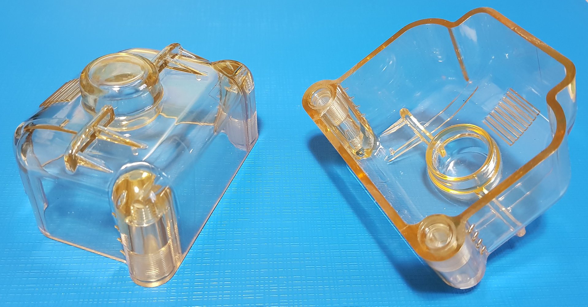

I find that removing the float bowls to measure can result in 'some' petrol coming out of the fuel line when the float drops.
Better to use a clear plastic bowl.
Re: Float adjustment
Welcommen 1991 R80RT. :)
float bowls-clear..jpg (289.79 KiB) Viewed 2425 times
1991 R80RT wrote: Sat Feb 24, 2024 8:26 am I find that removing the float bowls to measure can result in 'some' petrol coming out of the fuel line when the float drops.

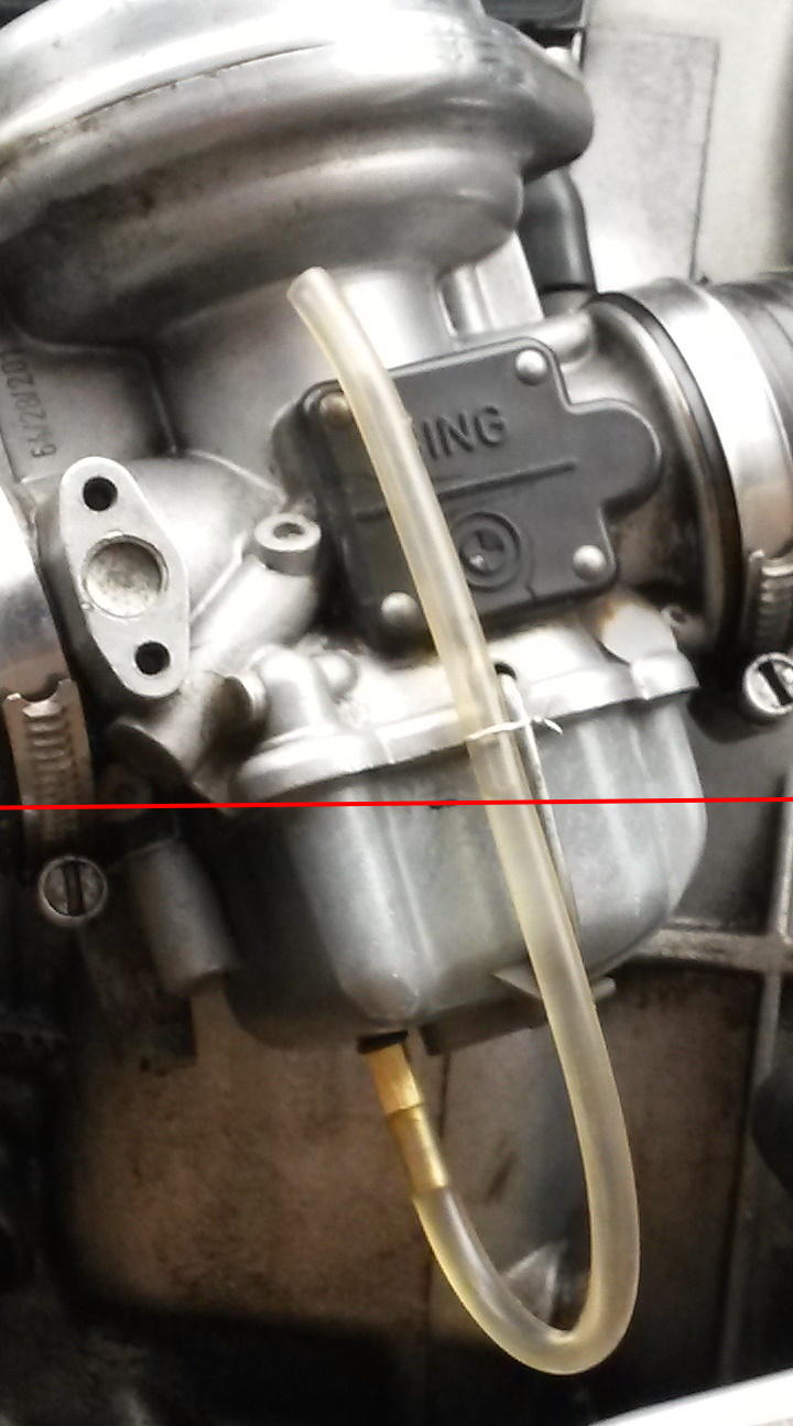

Agreed, back in 2017 at the start of this thread I was saying that measuring the level in a removed bowl was flawed, not just because of excess fuel flowing out of the fuel line but also because it's dependent on float buoyancy. At best it's an indirect method that relies on using new floats or floats of known weight. A clear float bowl is a direct method that shows the actual operational float level and it's surprisingly high. I came up with another direct method which was to drill and tap the float bowls and fit a level tube. With new floats fitted that gave me a benchmark to refer back to when checking the levels.

Nice idea Barry. Cheaper than the clear bowls.
