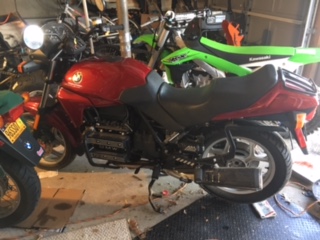

Thanks, just wondering if it should spin over easy in 5th gear turning the rear wheel? I know there is a lot of reduction and gears..

I mean with the spark plugs out of coarse. The oil was very thick.

Got the new fuel pump assy in and new battery. It cranks over fine. Have to put in some fresh gas and see if it will fire up. Also have ABS warning. Did re set, but it is still flashing. This thing is like the lunar module compared to my air head! :)

Hello all, I got the bike to fire and run, but it will not run on its own. I used starter fluid injected through the oil breather input to the air box. It is running too lean to keep running on its own. Is it likely that the injectors are gummed up from sitting so long? It is pumping a lot of fuel out of the new pump. I guess I should measure the fuel pressure at the rail to test the regulator, then all that's left are the injectors?

Oh hell yes, the injectors will need cleaning.
They are your carburetors.

This is what I was telling you !!
It's not going to run well until you get it out on the highway and run it 15-25 miles. You'll want to run a name-brand, high test, Top Tier fuel with built-in cleaners which you purchase the day of the ride. Fuels like Chevron and Shell have all that built in and will clean the injector system as you ride. It can't over-heat with water cooling.
Put some NEW NGK plugs in there and take it for a long ride.
When you get back, THEN you can worry about idle characteristics.
