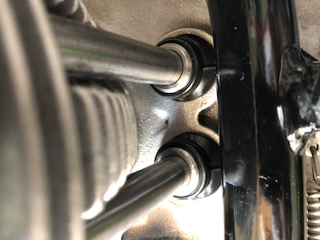

Push rod tubes fully inserted? Position of rods?
Push Tubes.JPG (27.98 KiB) Viewed 1924 times
