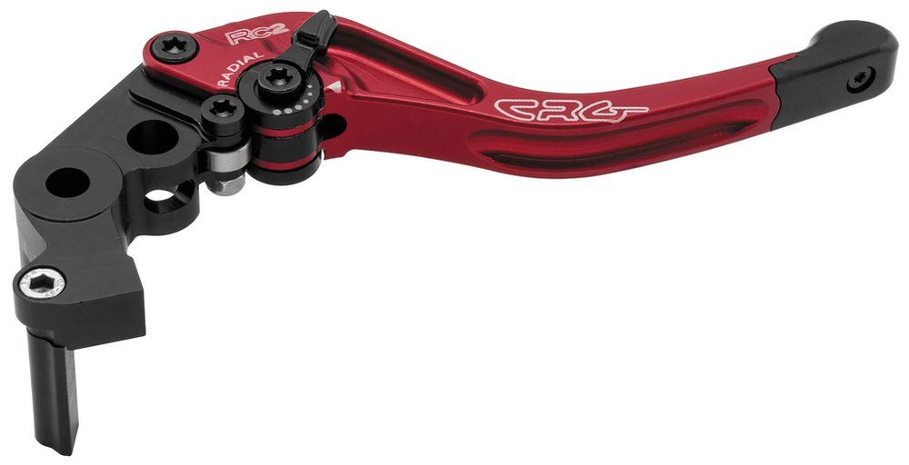

If you are not comfortable with how hard (or wooden) your brake lever feels, or if it is too far away from your handlebar to modulate precisely while braking and you personally feel that more more 'flex' or 'sponginess' is the solution(???) for you, don't add more flexible hoses. Just don't bleed all the air out. Air compresses, fluid doesn't. You'll get the same effect.
And air is free. :)
Adjustable levers (some with variable pivot points) exist so brakes can be 'tuned' for the individual rider, depending on their hand size and strength. I haven't seen any direct fits for our relic airheads.
As far as the rigid line between calipers, the very few actual failures (or near failures) I have seen were caused by sloppy wheel or caliper servicing. I've never seen one damaged by road debris or outside projectiles.
