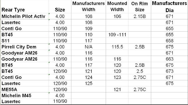

This must be 10 years old now but I had a go at comparing rear tyre sizes for width and diameter. The overall width also varies depending on the rim size on which it is mounted and when the manufacturer provides an overall width they usually specify it for a given rim size. I believe that in some cases a reason for unexpected dimensions is the inch size tyres and mm size tyres can be one and the same thing except for different printing on the side wall.
Tire Sizes.JPG (45.09 KiB) Viewed 2301 times

Thanks Barry.
There are just sooo many variables when it comes to choosing the right tire.
