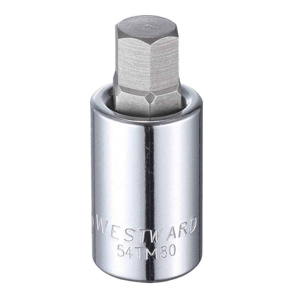

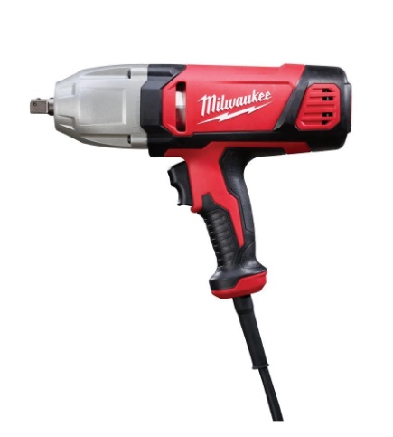

Jeezuzz, , I just have to butt in here.Rob Frankham wrote: ↑Fri Dec 03, 2021 4:40 am I think it is probably time to consider sacrificing the bolt.
Have you people never dealt with seized components?
Here in Quebec, they are the norm rather than the exception.
Everything here is saturated with road salt from December till March.
Get a 1/2" drive impact gun (air or electric) and a proper 1/2" drive hex bit.
That bolt will immediately come out with the first easy squeeze of the trigger, guaranteed, or I'm not GSPD.
The hammering action of the impact gun will break the bolt free instantly whereas applying a ton of force with a long extension will only damage the steering stops.
If you can't borrow one, can't afford one, or don't want to spend the money on one, just buy one at Walmart, use it very carefully, repackage it meticulously and return it.
Shop around and inquire about return policies first. All the 'big box' stores here in Canada (Walmart, Home Depot, Canadian Tire, etc ) offer totally hassle free returns, even on tools.
You're welcum

There are impact drivers, and then there are IMPACT DRIVERS.Rob Frankham wrote: ↑Fri Dec 03, 2021 12:57 pm Um... if you read the first post he's already tried an impact driver.
I'm curious...ozR65LS didn't specify the size and type of impact driver and socket he tried.
The impact energy is wasted if the socket is even slightly loose on the gun or if any reducers, adapters or extensions are used.
A good 1/2" drive gun with a tight fitting short 1/2" drive hex tip socket will surely get that nut off.
A 3/8" drive hex tip with an enlarger to fit a 1/2" gun does not provide anywhere near the same hit.
A 3/8" drive gun or substandard 1/2" gun won't either.
I also have a 3/4" 'Big Bertha' gun (with an oversize air supply hose) for the real bastards.
I don't recall ever resorting to that one on a airhead, but I needed it regularly in an another life to remove crusty VW Type II rear axle nuts.
As a very, very last alternative, heat the bolt with a small tip oxy/acetylene torch.
Start at the center and work your way outwards until the whole nut is glowing red.
Douse it with water, then hit it with the gun.

Can an $100. electric impact driver get this kind of job done?
