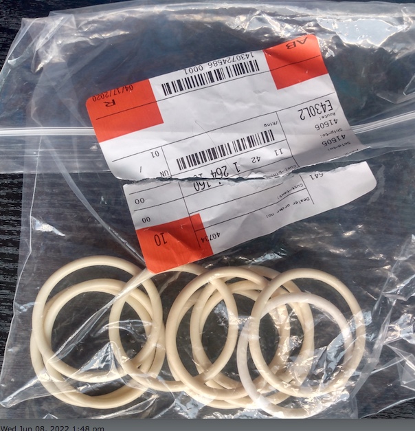

Tom H Ca wrote: Wed Jun 08, 2022 1:48 pm O ring #7. The filters I have been buying for my '73 R75/5 have the sorta cone shaped rubber ends on them. AFAIK, you do not use the #7 O rings with these filters???
Correct, you don't use the #7 O-rings if your filter has a rubber seal on both ends.
I've seen a few cases where the old rubber seal stayed in the engine and a new filter (with its 2 new seals) was squashed in over it.
The older style filters like yours can be installed in either direction. The later filters are much longer and the oil cooler ones only fit in one way.
The 2 piece hinged filters were developed to facilitate installation on bike with crashbars or lower fairings but work the same way.
Tom H Ca wrote: Wed Jun 08, 2022 1:48 pm Also on my R75/5 with the rubber end filters, I know there is a gasket on the cover, but I can not remember if there is a white O ring. I have not had external leaks and never had any oil pressure issues that I know of in about 10,000 miles. I would need to pull it to be sure.
If your /5 is original, it has a bolt in the middle of the filter and no white o-ring, just a gasket on the flat outer cover.
Tom H Ca wrote: Wed Jun 08, 2022 1:48 pm FWIW: The two oil streaks makes me think the push rod tube seals.
I don't think that much oil would (or could) come out of the pushrod tubes even if the seals were totally obliterated.
The oil returning to the sump via the PR tubes is a pulsed flow; it would externalize more like a slow drip than a steady RPM related pressure stream like in the video. I've seen that exact same leak many times and it was always filter related, and usually immediately after a well intentioned owner re-used his apparently good white O-ring.
I've had problems with more than one jobber O-ring purchased from otherwise reputable suppliers.
I now use (and STRONGLY recommend) ONLY OE BMW white O-rings. (I buy 'em by the dozen).
In contrast, I've never had any issues with quality jobber oil filters, knock on wood.
Tom H Ca wrote: Wed Jun 08, 2022 1:48 pm ALSO: To be clear.....The oil light came on at idle, BUT went out above idle right????
Low and hot oil could make the light come on at idle. Meaning MAYBE there was enough oil to lube the engine?
It's not that uncommon for the oil light to flicker a bit at low idle on an older bike when it's real hot, especially after a good beating;
That said, a knock is a knock, regardless of what led to it.
If the light stays solidly 'ON' at any time, you've got a problem; Insufficient pressure, crappy oil, no oil, or a faulty switch.
