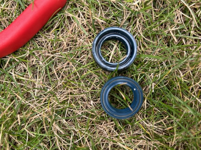

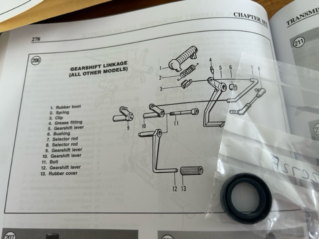

Hello Guys, well i got the seal and managed to lean the bike, remove the gear selector and remove the old seal without loosing any oil, so far so good however when i compaire the seals the old one is slightly larger than the new one and the new one is not a snug fit, so i abanded the change and reinstated the old one, any comments, i have gone back to the supplier. also in the techncial manual the seal is not even on the technical drawings (which i find supprising)

i have just re-read erics post on this subject and i can confirm that i have the 15mm seal, so that makes sense, the outer diameter is 24 and inner is 15mm, i will have another go and swap it out. cheers

It is shown in another diagram...#9 in this image:
https://www.realoem.com/bmw/enUS/showpa ... Id=23_0256
Interesting that it shows two different seals. One is from 9/74 which should be the right one.

i forgot to come back on this, i purhased a seal but when i removed hte old one it was a bit larger than the new one, so i put the old one back in, later on i realised it was bigger because it had been squahed into shape when the gear selector was tightened. however the good news is taking the seal off and putting it back on has resolved the leak.

So long as it works, then all is well, but that seal should NOT change shape when installed, and should not have any pressure on it from the shifter lever, so either something is very wrong, or we are talking about different seals."... it was bigger because it had been squashed into shape when the gear selector was tightened."
Glad you got it fixed!
