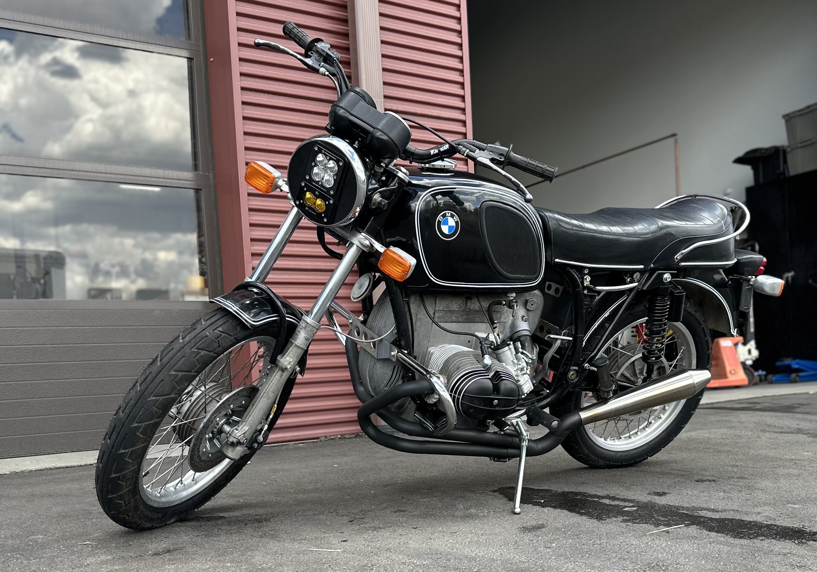

So I think it was actually a piece of a metallic type o ring, the ones that look like graphite. Does that make any sense. Ive got it running well, timing set proper as well as points. Getting some reading done on tuning the dellorto phm 38s it has on it, ordered some chock levers and nice hose clamps for the intake.
Re: 74 R75/6 electrical woes
She rips better than I expected, def needs the fork springs, dives super hard. I also need the brakes to work a little scary since it hits 90mph in hurry, thinking of trying pads, I rebuilt master and caliper and bleed with srf.

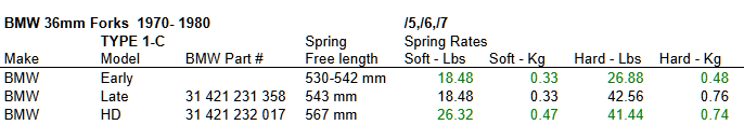

I like BMW's comfortable suspension. Some spring rate info that shows they got stiffer in later yearsRob Frankham wrote: ↑Sun Jul 13, 2025 6:40 am
Airheads are known for their 'soft' suspension, especially the earlier models... even when the form springs are new. Disconcerting until you get used to it but it does make for a very comfortable ride and doesn't really affect the handling. Changing the springs can make a difference but be careful else you'll end up with a very harsh ride and insufficient damping.
- 85- on spring rates.png (11.92 KiB) Viewed 35766 times
- 1970 -1980 spring rates.png (15.37 KiB) Viewed 35766 times
