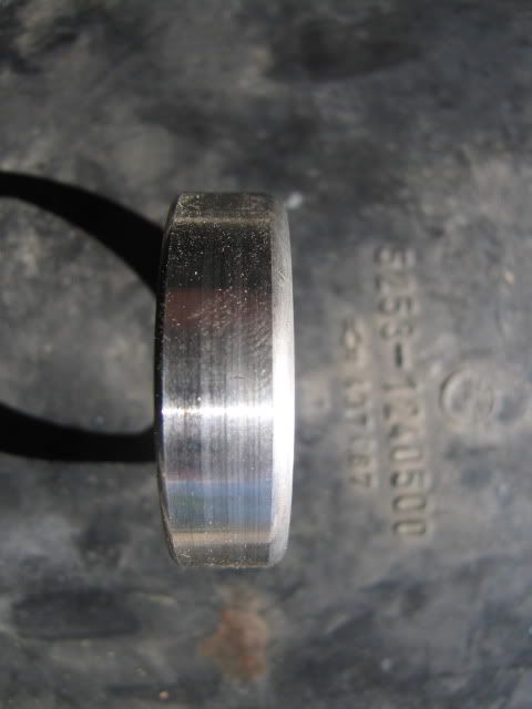

This is a 30203J bearing. Notice the large radius on the side of the bearing.
The 'seat' in the hub is about 3mm (1/8") wide.
The radius of this bearing means that it is supported by less than 1mm of hub.

ME 109 wrote:This is a 30203J bearing. Notice the large radius on the side of the bearing.
Who makes that again? It should be right on it---although that might not be what it really is or who really made it. Where did you buy it?
Re: WHERE DOES THIS PART GO????
It's an NSK bearing made in Japan.
I've had it offered to me by two bearing sellers in my area. The bearing is fine, the radius isn't.
The 30203 appears to designate the important part......40mm x 17mm
The height? of the bearing changes with prefix and suffix, I've seen (iirc) 10.5mm, 11mm, 13.5mm
Although these measurements don't really matter.

ME 109 wrote:It's an NSK bearing made in Japan.
Actually it designates it all. Prefixes and suffixes indicate variations in some cases. (precision tolerance, sub assembly, etc)
The heights can be confusing, there are 3, one for the outer race, one for the inner and one for the assembly. These are detailed on the Timken site reference I listed. They use an X and Y prefix for the inner and outer alone.
One thing I noticed poking around was a lot of Chinese distributors selling "name" bearings to the US. One listed country of origin of a 30203 as Sweden. Why would someone ship bearings to from Sweden to China so they can be shipped again to the US? The advantage of cheap Chinese labor hardly applies. A US bearing distributor buys from SKF ( for instance) and the shipping is either from the local SKF distribution point in the US (they make massive shipments to keep the cost down) or they are drop shipped from the Swedish (or Brazilian or other) plant. You don't bounce product back and forth around the world and make money. But one thing that is done, and the Chinese are known for it, is make counterfeits. Two guys in a shed (and here the cheap labor matters) can manually feed a laser engraver and turn $.75 bearings into $15 bearings to move on eBay or through other dubious channels. If the bearing you have doesn't meet the basic spec on the NSK site, (and it doesn't) maybe it ain't a NSK bearing? If I had been able to find a 30203J bearing with the spec. you note, I wouldn't be thinking these thoughts. I only gave it a half hour...but try it yourself. Every bearing manufacturer publishes drawings and dimensions of their stuff. Find a 30203J. I think I gave a reference to the NSK catalog, scroll down, right side of the page. There is the 30203J with all it's dimensions. The radius listed isn't what you show in your pic. So sumthin' funny.
A big radius on the outer race is odd. On the inner race is common. When you do a shoulder on a shaft you might put
in fat radius to avoid a stress riser. So the bearing is made to match this. But outer races go in bores and the need for a big radius is uncommon.
I noticed the 30203J was being called out for a number of inferior brands of bikes and ATVs. You might drop by one of those dealer (in dark sunglasses) and see what one of theirs looks like.
