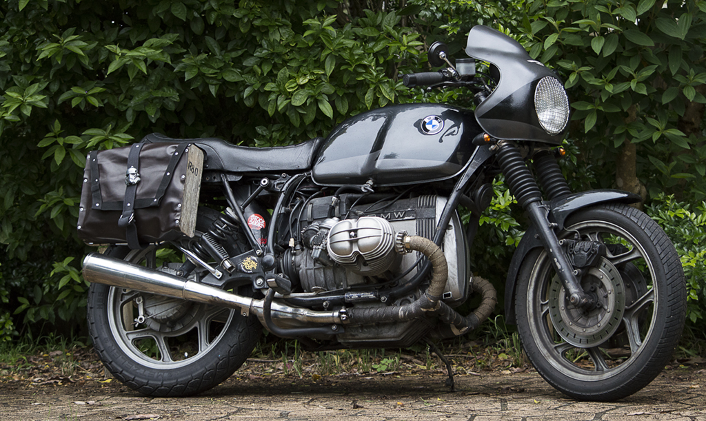

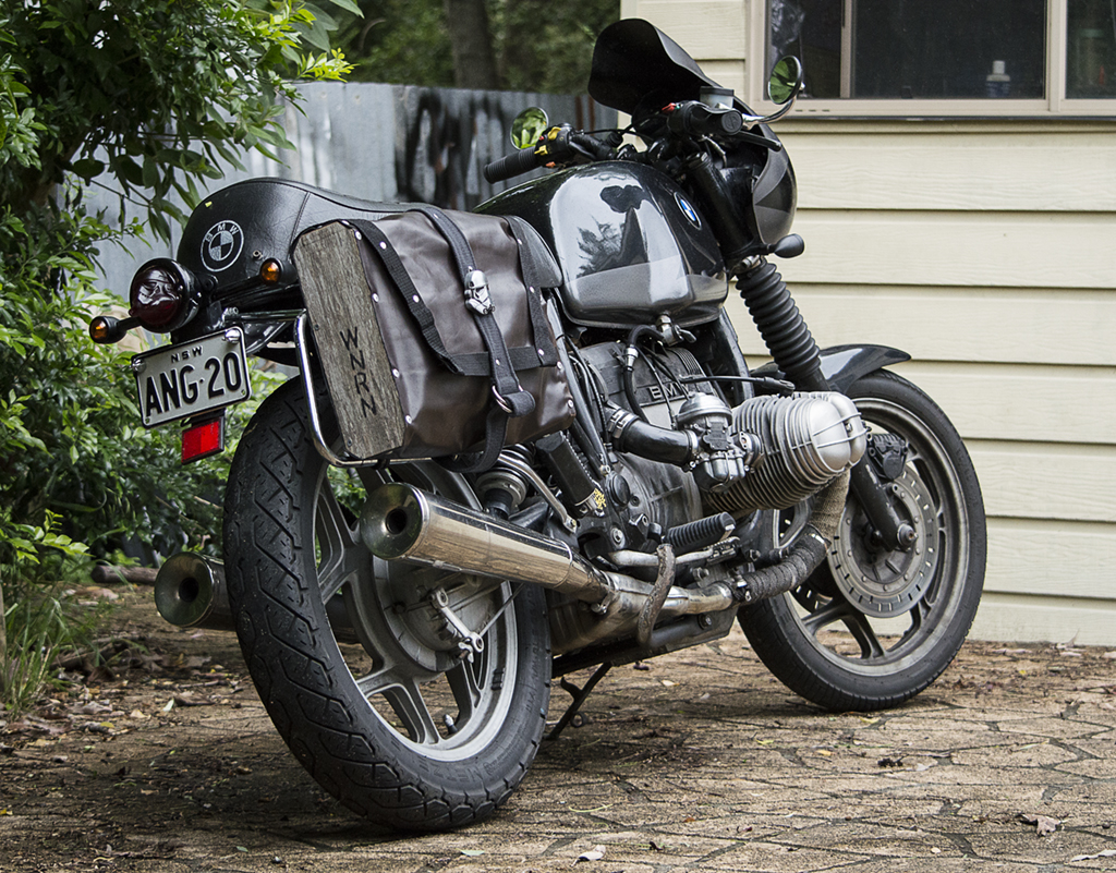

Didn't modify the loops at all. Just made 8 brackets to mount/bolt them to the loops. That way i can unbolt them and then put the Tardis BMW bags back on if i need to.
Ross
Posts: 888
Post by Ross »
I like to be different. Its who I am. So when I stumbled across pushbike saddlebags that had wood as part of them I knew I had to make one for the BM.
A fence paling. Some treated pine. A huge bit of leather I got off my sister. My imagination. A Starwars Storm-trooper keyring. Some old straps. A fabric belt of mine. Screws and rivets. Design in my head. Then make.

Never say done. Will I change or do more? You bet. When? When an new idea comes into my head.
What I started with on 8 August 2015 and were it is today 15 November 2015.

Imperial Street Tracker.
Yeah changes don't stay changed for long.
Street tracker is being slapped together.
Need to replace all the cables.
So why not put a set of old Suzuki ER185 bars on first. I love reusing old shit bike parts.
Had to reduce the diameter of the bars with a sanding wheel in the drill so the controls would fit.
Move the front brake cable. Replaced the brake fluid. Brakes have now lost that wooden feeling.
Go for ride. Super comfy. Sitting upright. My hips and shoulders say thank you.
Next up is new cables and planning in doing away with the instrument pod and replacing that all with a small GPS speedo. I have some ideas for a different headlight too.
