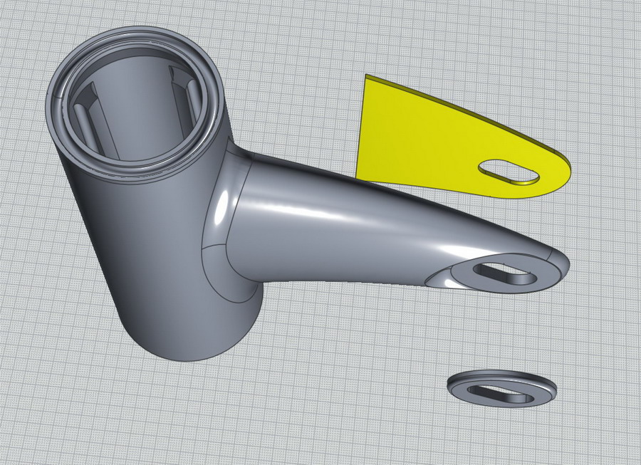

Thanks kmisterk. Yes, I'll be able to send you the STL files for the bucket, supports and other bits. Send me a PM and include your email address. My stuff is printed with ABS+ but there may be other options, particularly if you have access to a resin printer. ABS filament printing has its challenges and I had to do a lot of tweaking to get sufficient strength. The temp controlled enclosure, at 60C, made the difference in preventing warping during the print.

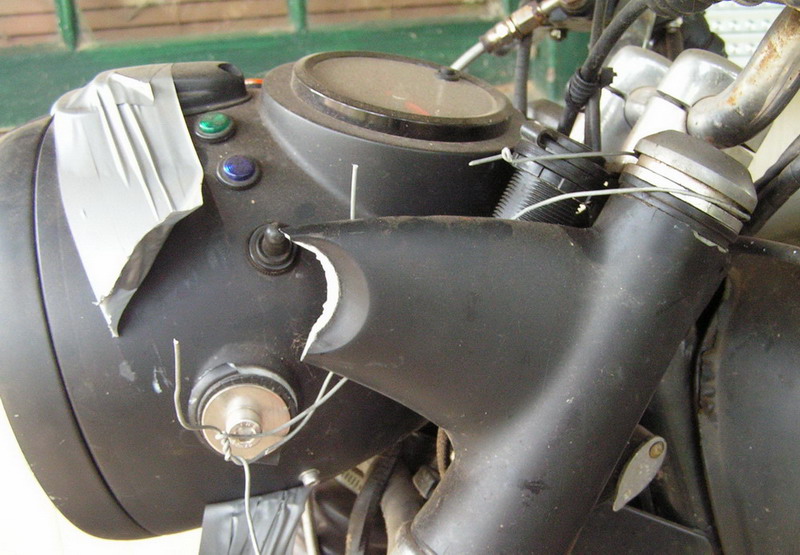

My first attempt at a printed bucket and ears went well for a couple of years but a trip in 2019 on the same bloody road - the Barry Way in southern NSW - when it was dry and very corrugated, saw the fronts of both ears break and the headlight dangling by its umbilical cord.
I redesigned the ears to include a groove for an o-ring at the top and made an aluminium reinforcing plate that is glued on with West System epoxy.
If by 'cluster' you mean the warning lights, those bits were also printed. More later ...

"Some background information: Brunhilde came into my care 19 years ago as a basically stock example [edit: of a /6] with 153k kms on the clock. A few months later we had a midnight collision with a black cow, resulting in significant damage to the bike, the cow and myself. The forks were bent, the original small tank had a knee-shaped dent, the handlebar was bent to the point where the front wheel could not point forward, and the front mudguard, headlight and instruments were totally trashed. The VIN plate on the steering head was even scraped off by the headlight, and I had to go back to the accident scene to find it. So the bike was no longer a stock example, but hey, what an opportunity to start modifying! The cow died the following day and I had my left shoulder rebuilt with aftermarket parts.
Since that time she’s worn a variety of headlights and instruments, always heading towards the Slash Five aesthetic, since I’m a Slash Five tragic who could only find a Slash Six at the time I had sufficient dollars to consider buying a BMW airhead. Thanks for reading."
So I was on the lookout for a /5 headlight bucket and ears, now very thin on the ground. A request on the ADVRider forum led to getting the loan of a (barely bashed) bucket from the US, and an Australian mate sent me a set of ears. I measured and modelled these, made adjustments to suit the cheap bits I wanted to fit and started printing. There were many fails but I'm now close to something that pleases me.
Or more briefly, I wanted something that I couldn't afford so I had to make it.
