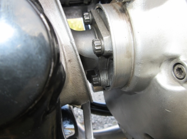

Dry at last!.jpeg (85.49 KiB) Viewed 1367 times
Just got back from a 350 km beat test test ride.
Not a hint of a leak, not even a minor sweat!!! :)
I left the front boot off so I wouldn't have to remove the clamp and stick my finger in the boot to check for leaks.
It felt almost preverted to ride around with my shaft exposed. :o
A few blips up to 100mph, but mostly not too much over-speeding because it's the start of the Canadian Thanksgiving weekend and the blue meanies are out radaring in full force to prevent road carnage fill their coffers.

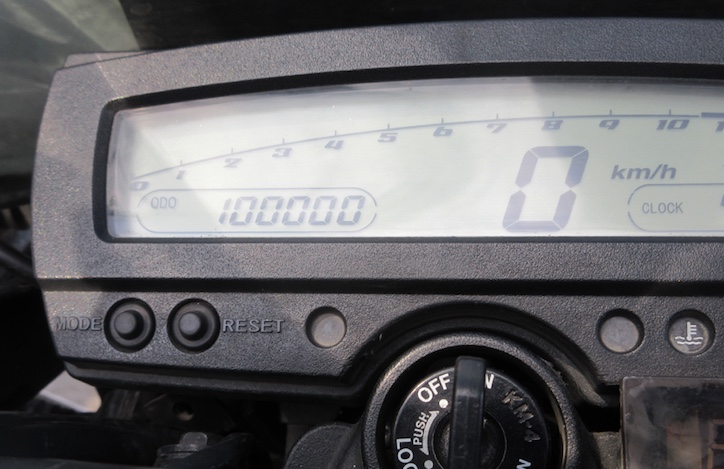

Another surprisingly pleasant but unrelated note, my wife's klx 250 300 just turned 100,000km.
Never thought those little bikes were so tough.
