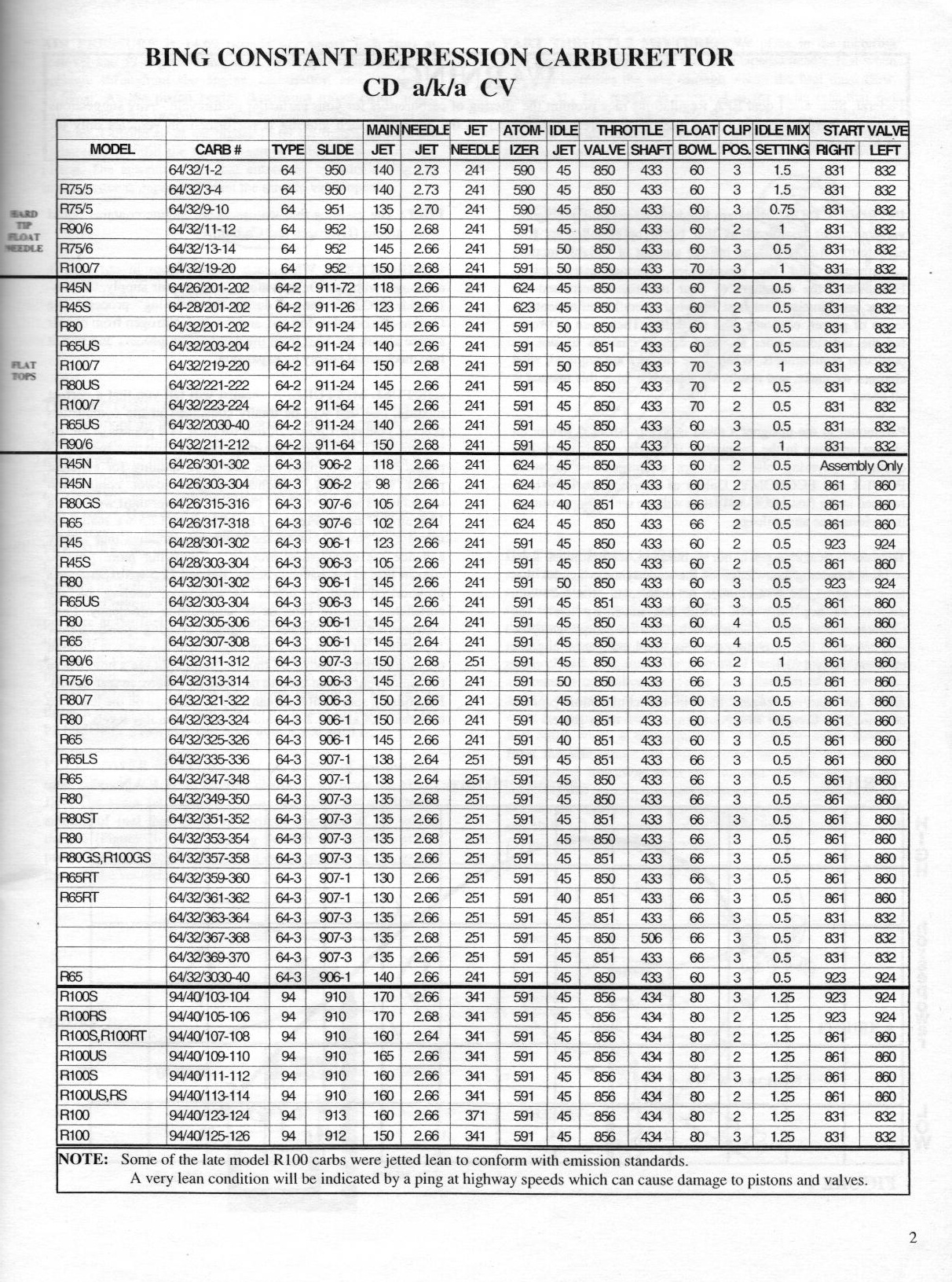

Always best to warm the bike up via a 20/60 ride before doing the carb tune.
https://bmwr65.org/htdocs/yabbfiles/Att ... by_ear.pdf
BING jetting chart.jpg (930.61 KiB) Viewed 102124 times
Hope that helps...check your carb numbers against the chart for the factory settings. [/color]

Thanks Steve, I've checked the numbers against the info in the Haynes and online and all checks out for the model numbers. Only the needles seemed to have a different finish (LHS looked polished like steel, RHS looked matt like aluminium, my hunch is the LHS is worn more). I need to open them up again as I foolishly didn't check the needle projection length after pulling them out 2 clicks, and I'm going to order new jets and needles anyway..
