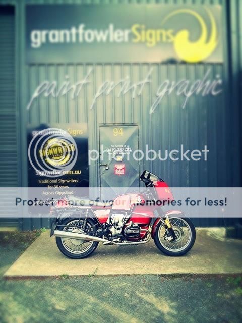

Done a 103kms of varied speeds and revs this morning to bed the new rings in, some winding, some straight, up hills, down hills, under load, all sorts of stuff but constantly varying the rev range as I was told to do.
Not a oil leak, fuel drip or smoke to been seen anywhere :) .. No not just a smile, this calls for a big ole cheesy grin :D
Cheers, Grant

She went lovely did the ole flying bloody clot..
Cheers, Grant
