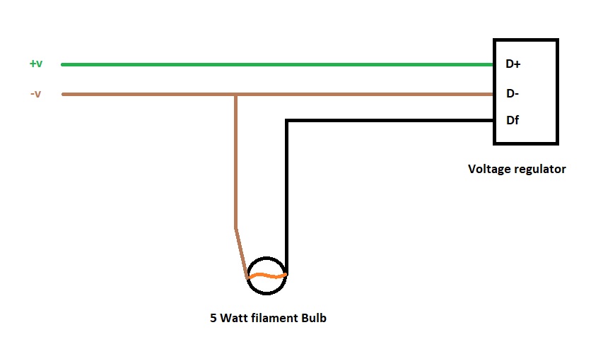

There is a way to test an electronic voltage regulator... but... it requires a variable bench power supply capable of supplying a substantial (say 5 amps at more than 15 volts) current.
Simply connect the regulator and the bulb as shown in the diagram below. Switch on the bench supply with the voltage at - say 8 volts and slowly increase the voltage. The bulb should light and grow brighter until a voltage somewhere between 13.5 and 14.5 volts is reached, the actual critical voltage will depend on the regulator. When the critical voltage is reached, the bulb will go out. Lowering the voltage slightly will bring the bulb back on again. The on/off switching should be complete (i.e. the bulb should go out completely) and be virtually instantaneous (there may be a point where the bulb flickers slightly but that will be due to the sudden switching of the bulb affecting the stability of the supply). The critical voltage (i.e. the supply voltage where the bulb switches off) is the set voltage of the regulator and approximates the maximum voltage the functional charge circuit will attain.
It's a very simple test but it does require the use of an 'infinitely variable' bench power supply.
N.B. this test will not work well with a mechanical voltage regulator
Re: Charging voltage too high?
There is a picture of my set up doing the above bench test back earlier in the thread on page 3. Rob's diagram shows how simple it really is provided you have a suitable bench power supply similar to the one shown. I wasn't doing it as a test but to adjust the set point on the original electromechanical regulator which is still working fine at 44 years old.
