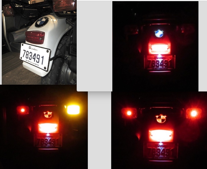

You're not fooling anybody, those lights are $10 Walmart trailer lights.
That's what I use as a tail light on my custom(ized) 100% LED rear end.
mods include....
Walmart trailer light, installed from inside in custom re-molded 'hole'.
BMW emblem is 82mm (car hood size) and translucent. (Stock is 70mm).
Emblem is blue mit white as running light, red when braking, looks stock (metal) in daylight when off.
Turn signals are solid mount (and tucked in) instead ofsaggy flexible OE stalks.
Turn signals are bright red when braking, brighter amber when signalling turn or 4-ways.
Licence plate light is 'legal' but purposely makes plate hard to read at night.
other custom touches....
Fender was shortened and squared off.
Saddlebag cross-mount goes inside the fender instead of outside.
Licence plate has no visible support or fasteners.
Super-Trapp (loud) muffler.

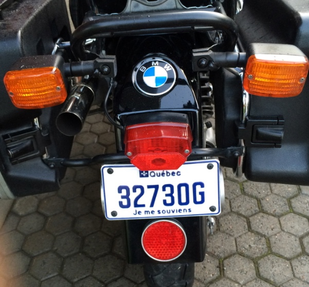

To really appreciate the cleanliness of this setup, compare it directly to a stock bike. (last pic)
notice small(er) tail light is loosely rubber mounted to fender with external wiring.
Saggy flashers.
(Incandescent bulbs needed rubber mounting to survive off-road use)
Hideous reflectors preventescape total stealth mode at night.
(I can have my headlight on and ALL other lights off if I so choose)
