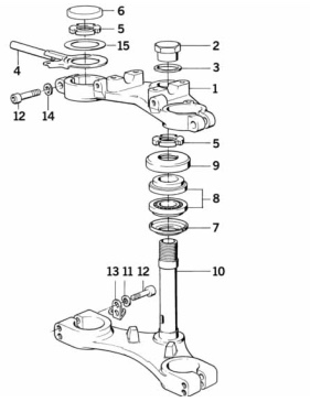

Has anybody installed grease fittings on the steering head bearings?

Honestly can't think of a practical way to do that...Zombie Master wrote: ↑Sun Sep 19, 2021 1:41 pm Has anybody installed grease fittings on the steering head bearings?

I tried it a few decades ago.Rob Frankham wrote: ↑Sun Sep 19, 2021 2:28 pmHonestly can't think of a practical way to do that...Zombie Master wrote: ↑Sun Sep 19, 2021 1:41 pm Has anybody installed grease fittings on the steering head bearings?
I machined an aluminum plug to press fit into the bottom hole of the steering stem.
Installed a grease nurple on it.
My thought was that pressurized grease would fill the steering stem pipe (it did
The vertical tube frame section has cutouts that open into the main backbone tube so instead of the grease being forced out through the bearings to the outside, all I succeeded in doing ifs filling my frame backbone with grease. Luckily I stopped after about a tube and a half of grease
It would work if the passage between the short vertical frame tube and the backbone tube was sealed off (welded closed) but I never got around to doing that. Maybe next time my frame needs powder-coating I will.

What about the hole at the top of the pipe? Did you block that... if not, surely the grease would simply exit there and go all over the top yoke. Of course, that wouldn't be satisfactory for models with steering dampers anyway.
My other comment would be that it would take an awful lot of grease and given the semi-solid nature of grease, it would tend to work it's way out of the lower bearing under gravity (there being no grease seal) and give a constantly recuring problem around the lower yoke.

My model has a solid cap in the top, no steering damper hole.Rob Frankham wrote: ↑Mon Sep 20, 2021 5:50 am What about the hole at the top of the pipe? Did you block that... if not, surely the grease would simply exit there and go all over the top yoke. Of course, that wouldn't be satisfactory for models with steering dampers anyway.
There are no 'real' seals, top or bottom, on all models.
Gravity could theoretically cause slight seepage but I don't see that being a major concern if thick grease is used.
Maybe it would just need a bit of wiping off once in a while.

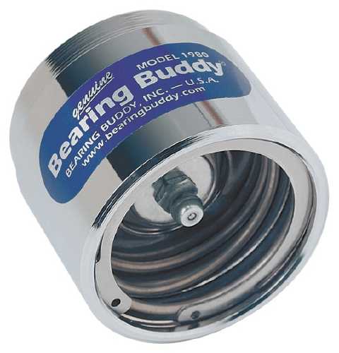

I got the idea while looking at a spring loaded grease cap for boat trailers. The nipple moves out towards the circlip as you fill it with grease. The (weak) spring slightly pressurizes the grease, constantly pushing it through both bearings to keep water out. You just keep adding more grease as the spring causes it to slowly seep out the other end bearing seal over time. This eliminates the need to regularly disassemble, clean and repack bearings. Obviously the spring would not be needed in steering head applications.

Given your username, I would guess that your bike is a GS (see, told you I was quite bright...
) few other models use a solid top cap.... however, the caps can be obtained and retrofitted if you can do without the steering damper (on models that have one).
