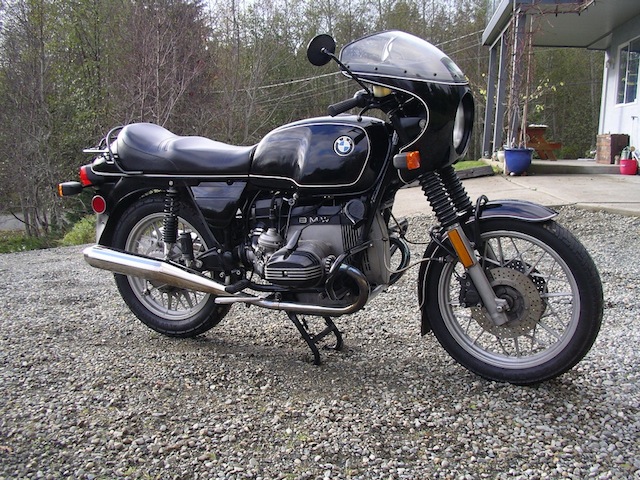

I put the hd BMW fork springs in a long time ago, they seem to be sitting up fine. Isn't the ride height the issue? I'm more worried about deteriorating bumpers and internal parts.
No bumpers, and only about five bits in there. I haven't worn mine out yet.
Although I did put a 12mm spacer on top of the springs. Noticeable.
