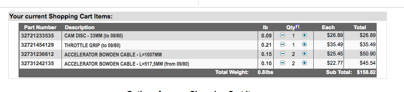

Wonder if this would cover it?
Screen Shot 2021-02-19 at 12.03.40 AM.png (46.14 KiB) Viewed 3273 times

by Rob Frankham
Three points...
1) Do you know if you require a replacement cover for the bevel gear recess? The designed was changed, not sure when, and the older style cam disk and cover are no longer available. The later type work perfectly but only if you replace both.
2) I'm a bit confused about the cables. You either need three cables if the handlebar mount only accomodates one (i.e. one from the handlebar mount to the splitter under the tank and one to each carb from the splitter) or, if your mount accomodates two, you need two longer cables one for each carb. The arrangement varied by year. I think yours should be the arrangement with a splitter but I'm not sure.
3) If you do have a splitter, it's worth examining it to see that it's in good condition while you're changing everything else.
Re: Throttle feel
Posted: Fri Feb 19, 2021 6:00 am
by Zombie Master
Yea I should only need one cable to get to the splitter, I have to determine which part number that is. I'll have to measure the cam disc to see if I need a new cover. I'd like to get the OEM heated grips. I wonder how well they work. I could always install undergrip heaters. Are there switched accessory jacks in the headlight?
Thank you ! :geek:
