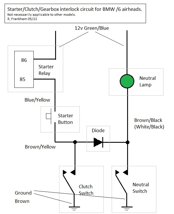

If this is true, the issue is almost certainly in the circuits that earth the ground side of the starter button. This is the matrix of switches and diodes that provides a ground when the bike is either in neutral or the clutch is pulled (or both). Some questions...
1) Have you tried starting the bike with the clutch pulled?
2) Does the neutral lamp on the dashboard work correcly?
With the answers to these questions, it should be possible to say where the problem is.
I am attaching a functional wiring diagram for the Starter/Clutch/Gearbox interlock wiring which may help with the problem. There is one inaccuracy... the label Green/Black at the top should read Green/Blue.
Let me know the answers.

OK, so here is the diagram... I've corrected the wire colours...
If you can answer the questions in my previous post, it shouold be possible to pinpoint the source of the problem.
