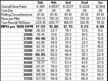

Your rolling circumference at 56.7 " seems too low. I think you must be using the wheel diameter 18" rather than the tyre diameter 26". On an airhead 18" wheel rolling circumference is more like 81"
This is what I get for a 2.91 final drive.
- Capture.PNG (11.48 KiB) Viewed 3403 times
- Posts: 1712
Re: Gear ratio confusion
I get more or less the same thing as barryh when I substitute 26 inches...I had been using 25.6 inches for the diameter. Question...how do you get from 26 diameter to 81.10 rolling circumference? Straight math gives you 81.7 circumference. Are you accounting for tire flattening when sitting on the bike?

That spreadsheet is 10 years old but I recall attempting to measure it by rolling an unladen bike. Might not be very accurate. Then to counter that there is the effect of the tyre increasing in diameter at speed. I don't think the calculation can be done very precisely as there are other variables like a new 4.00 x 18 tyre can vary between 26" and 26.4" in diameter depending on make and then of course they wear.Kurt in S.A. wrote: ↑Thu Oct 04, 2018 3:32 pm I get more or less the same thing at barryh when I substitute 26 inches...I had been using 25.6 inches for the diameter. Question...how do you get from 26 diameter to 81.10 rolling circumference? Straight math gives you 81.7 circumference. Are you accounting for tire flattening when sitting on the bike?
