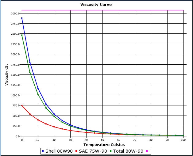

I've had synthetic 75W90 in all 3 parts of the transmission for several years. No problems in terms of leaks and the oil is much thinner when cold which reduces drag. With the bike on the stand and cold oil try spinning the rear wheel by hand in neutral. You will feel substantial oil drag. Do the same when the oil is hot and the difference is incredible. 75W90 reduces much of that cold oil drag.
Look at the difference in cold viscosity between two different mineral 80W90's and a typical synthetic 75W90. The way I look at it we lose a lot of power between the flywheel and the rear wheel and if I can get a few percent of that back for negligible cost it's worth while. I do daily short commutes where the oil never really gets hot so I probably benefit more than most.

Inserting graph. probably going to use it next change. Is the same true for engine oil? I've never tried synthetic in the motor either.
