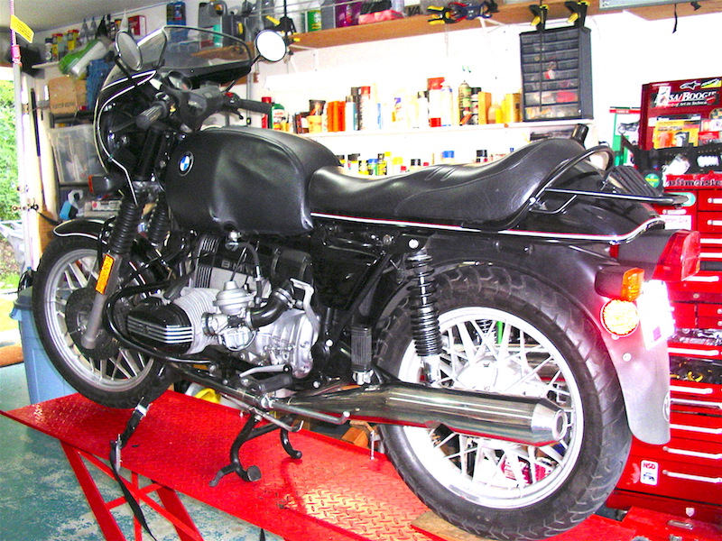

Thought I'd continue this thread with a new start.
1984 R100 with snowflake wheels, drum brake.
We were discussing balancing wheels.
I'm going to be installing Michelin Pilot Activ in 4.00 18 /3.25 19 Or if I can't get those, I'll try the new Bridgestone B46 in the same size.
They cost about the same. The only reason I'd go for the B46 is that they are a new model, so I know they will be fresh. When ordering tires, you never know how old they are before you get them.
After reading your cautions about internal wheel balancing methods, I've rejected that approach.
Not sure why my local dealer can't balance these wheels, but he says he can't.
Is there something unusual about these wheels?
The dealer is able to balance my other bikes no problem.
A friend has this wheel balance stand that I can use:
https://www.amazon.ca/Venom-Motorcycle- ... 6528&psc=1
Would I need to do any adaptation for my wheels? Or does a stand like this have enough adjustment to fit?
I plan to install new seals on the front, so I'll be purging the old grease. I can oil the bearing for balancing, then fit the new seal with new grease.
Any thoughts would be appreciated. :geek:
