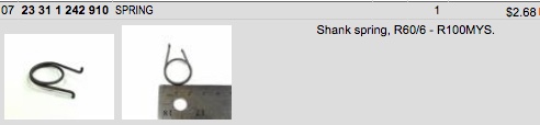

That #$%^&*@! pawl spring is the Achilles’ heel of these transmissions.
After the first few unscheduled breaks at approximately 160,000 km intervals, luckily stuck in 2nd or 3rd gear so I could ride it home, I started begrudgingly replacing the little bastard at 100,000 km intervals as part of my self-inflicted scheduled maintenance plan.
I’m not sold the counterweight idea unless it can be demonstrated that the transmission will shift (as) perfectly with the spring permanently deleted… otherwise , you’ll still have to take it apartif when the spring breaks. The bob-weight mod might permit shifting when your spring does break, but I think it will hinder the shifting experience the rest of the time..
in a perfect world, some genius with a PHD in metallurgy would re-invent what was probably acceptable spring steel technology and material 50 years ago with something indestructible that NASA would use on the space shuttle today. I would gladly pay an exorbitant price ($100!?) for an exact unobtanium replacement for this $2 chineseium BMW crap spring.
To keep things in perspective, I just replaced a broken spring that has a similar function in a friend's 998 Ducati a while ago.
It had only 30,000 kms on it.
