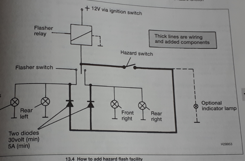

As per Robs request here is the schematic for the mod re hazards. its from the Haynes Electrical tech manual.
Hazard option.PNG (548.13 KiB) Viewed 1252 times

Thanks for that. It's woth noting that the flasher relay would also need to be changed for a 'hazard' flasher relay. It won't work with just any OEM relay.

I don't understand why that setup won't work as shown.
Take away the thick black added-on wires and you have a stock setup, right?
If the stock setup works, the add-on thick stuff should work.
The relay doesn't know if your connecting to one side at a time with the flasher switch, or to both sides via the added 'hazard' switch.
Obviously, wired this way the flashers (and 4-ways) only work with he ignition 'on'.
The often problematic (and expensive) OE hazard flasher setup found on some airhead models can only be activated when the ignition is on. Once the 4-ways are activated (with the key on) the ignition can be shut off and the key removed and they will keep flashing until the voltage drops to approximately 11 volts. They can be turned off any time, but the ignition has to be turned back on to re-activate them.
I suppose this was so you could leave your broken 'flashing' bike unattended on the side of the road without the key in it while going to look for help and not return to a dead battery. Only the person with the key could turn on the flashers, but anybody walking by could turn them off.
Now everybody (except me) has a cell phone so there is usually no need to leave a bike unattended, just call and wait for help to arrive.

With most traditional flashers, the rate of flash is dependant on the value of the load. A flasher unit which is designed to work with 2 x 21 watt bulbs and a repeater will not work properly with 4 x 21 watt bulbs (and a repeater). what will actually happen depends on the flasher unit... it could flash at the wrong rate, it could not flash at all or, in some cases, it might even destroy the flasher unit. What it is highly unlikely to do is flash at a rate withing the specs. The answer is to replace the stock unit with a flasher that is designed for use with a hazard flasher system.
