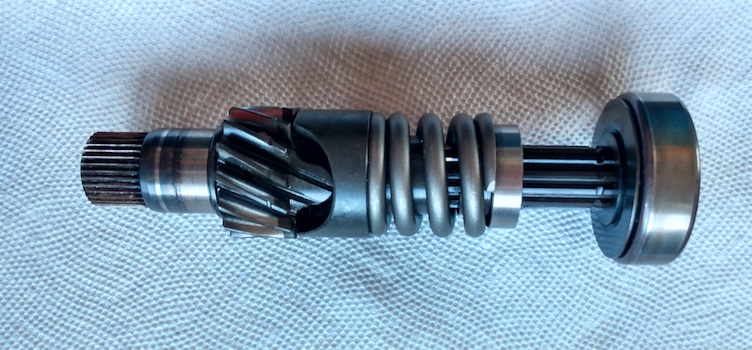

I've never personally experienced the effects of a input shaft spring failure.(very, very rare)
Some adjacent parts are no longer available from BMW but the spring is (for under $20).
If you're lucky all you need is a spring and a gasket and a few hours labour.
A relatively easy fix.
Where are you located?
I have a used input shaft, unfortunately it's not for a r65.
- shaft.jpeg (134.66 KiB) Viewed 2333 times

The gearbox on a R65 is the same as that fitted to all contemporary models. Unfortunately, not all transmissions fitted to R65s are the same. If that shaft comes from a comtemporary transmission, it will work. Dofferences are in the pitch of the primary drive gear and the length of the clutch spline on the nose of the shaft. If the gearbox is fitted with a kickstart, there will also be a matchiong gear on this shaft..
Re: R65 blown clutch??
I stand corrected.Rob Frankham wrote: ↑Sun Jun 12, 2022 5:17 amThe gearbox on a R65 is the same as that fitted to all contemporary models. Unfortunately, not all transmissions fitted to R65s are the same. If that shaft comes from a comtemporary transmission, it will work. Dofferences are in the pitch of the primary drive gear and the length of the clutch spline on the nose of the shaft. If the gearbox is fitted with a kickstart, there will also be a matchiong gear on this shaft..
I should have said "unfortunately it won't work in jjkklm1010's 1979 r65"
Thank you.
