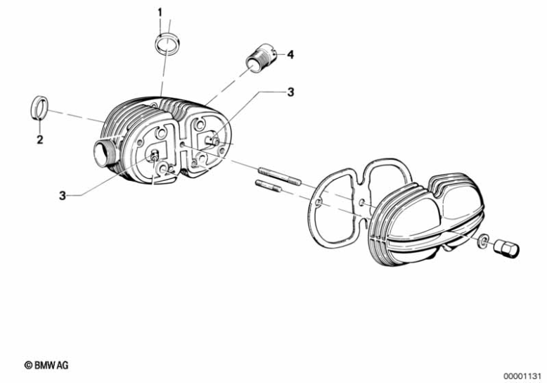

Re #4...air leak. Before you did anything, I think I'd just check a couple of things re a leak.
1. whilst idling spray something all around the carbs and connections, whilst listening for a change in the idle. You might find a leak.
2. does the /6 have a removable spigot at the head where the carb manifold attaches? If so, ensure both are tight. I had a similar problem on my 82 RS years ago. Correction of the loose spigot solved it.
#4...
I'd be pissed if I did all the other stuff to find that it was a simple spigot leak.
