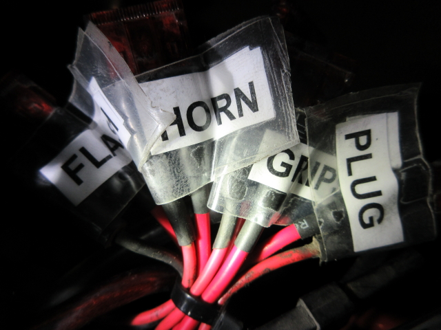

I needed to add some fuses, to protect a bunch of circuits and relays I added; horn relay, hot grip relay, flasher circuit, accessory plug, and one for the unfused main wire that goes to the ignition switch.
There are all kinds of fuse holders on the market, but my solution was to simply connect the fuse to two spade connectors and cut out the middle man. I shrink wrap the terminals and just plug the fuse in. I've labelled them for easy identification. The whole mess is tie-wrapped together so nothing can shake loose, and sits dormant atop the plastic airbox for easy tool-less access. Initially I was a bit concerned if the actual fuse body would break with vibration and stress, or if corrosion would eat them away, but most have been there for decades without an issue (some are more recent additions).

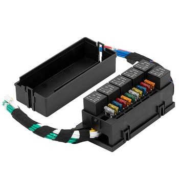

If I had the space to install one of these I'd rewire my whole bike so each component would have its own designated fuse and all the appropriate circuits would have relays. There's just no room for it anywhere.

Yes, the Mo-Unit Blue is expensive - I threw 500 of our little Aussie dollars at it. I was only able to justify the expense because our PM made a surprise bonus payment to age pensioners when Covid was particularly busy here. I had been planning to install something like the box of fuses and relays that GSPD pictured above. I had drawn up about half of the horribly complicated wiring map when it occurred to me that there must be an easier way, and the Mo-Unit popped into my vision.
