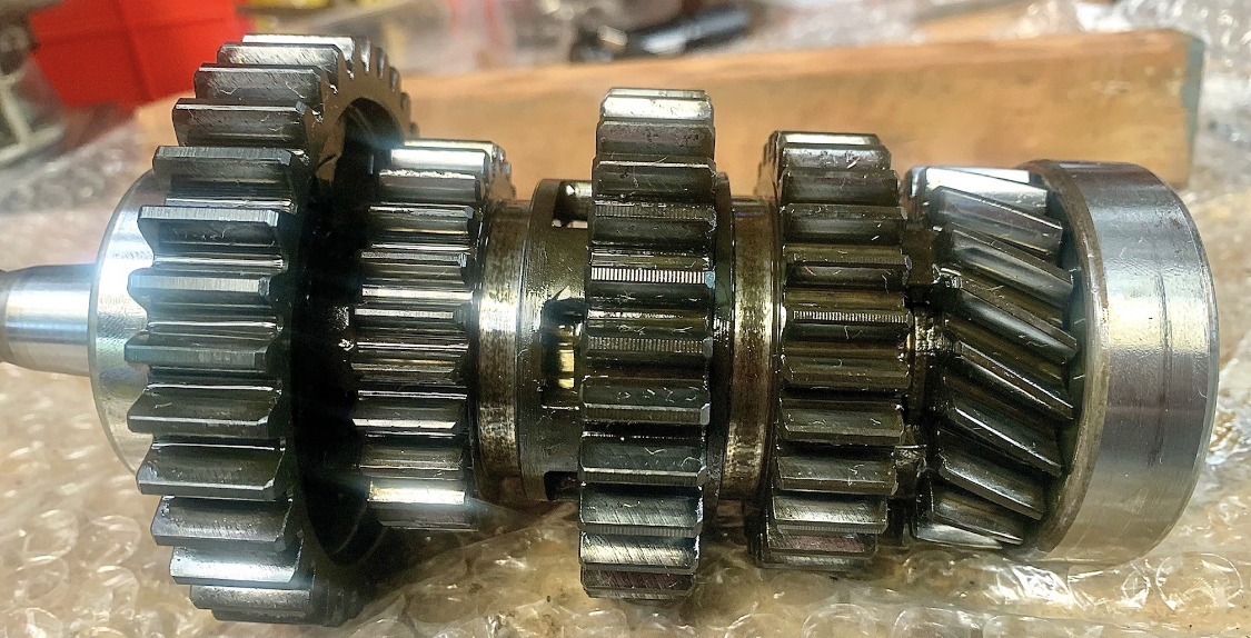

I’ve dismantled a spare 5 speed circlip trans. Its history is unknown to me.
2nd and 3rd gear have a little pitting on maybe 6 or so teeth. 5th gear is mobile on the shaft but not so much when 3rd is up against it , the front bearing has a tiny amount of movement only but spins nicely. There is a circlip but no snap ring. I have no history of this trans. The case is ribbed, the helical gears don't have the markings of the later ones.
There were no shavings or chunks in the box. Everything looks intact, all dogs look square and unchipped.
Next step will be to remove the front bearing and inspect the shaft.
Any comment on the state of the 5th gear in the video?

Hard to comment without the actual parts in hand.

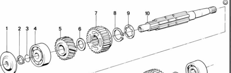

Is it possible that washer # 6 is missing?
The shaft has longitudinal lines where 5th rotates on it.
Those lines will help you establish how worn the shaft is.
Pitting on gear teeth is never good, but it's not necessarily a deal breaker.
Replace that gear if you can. Wish for the best if you can't.
It'll probably run forever as it is.
The 23 12 1 338 795 bearing FROM BMW, has no taper on it's inside race where it contacts the circlip #2, rendering the wire spring clip #3 obsolete.

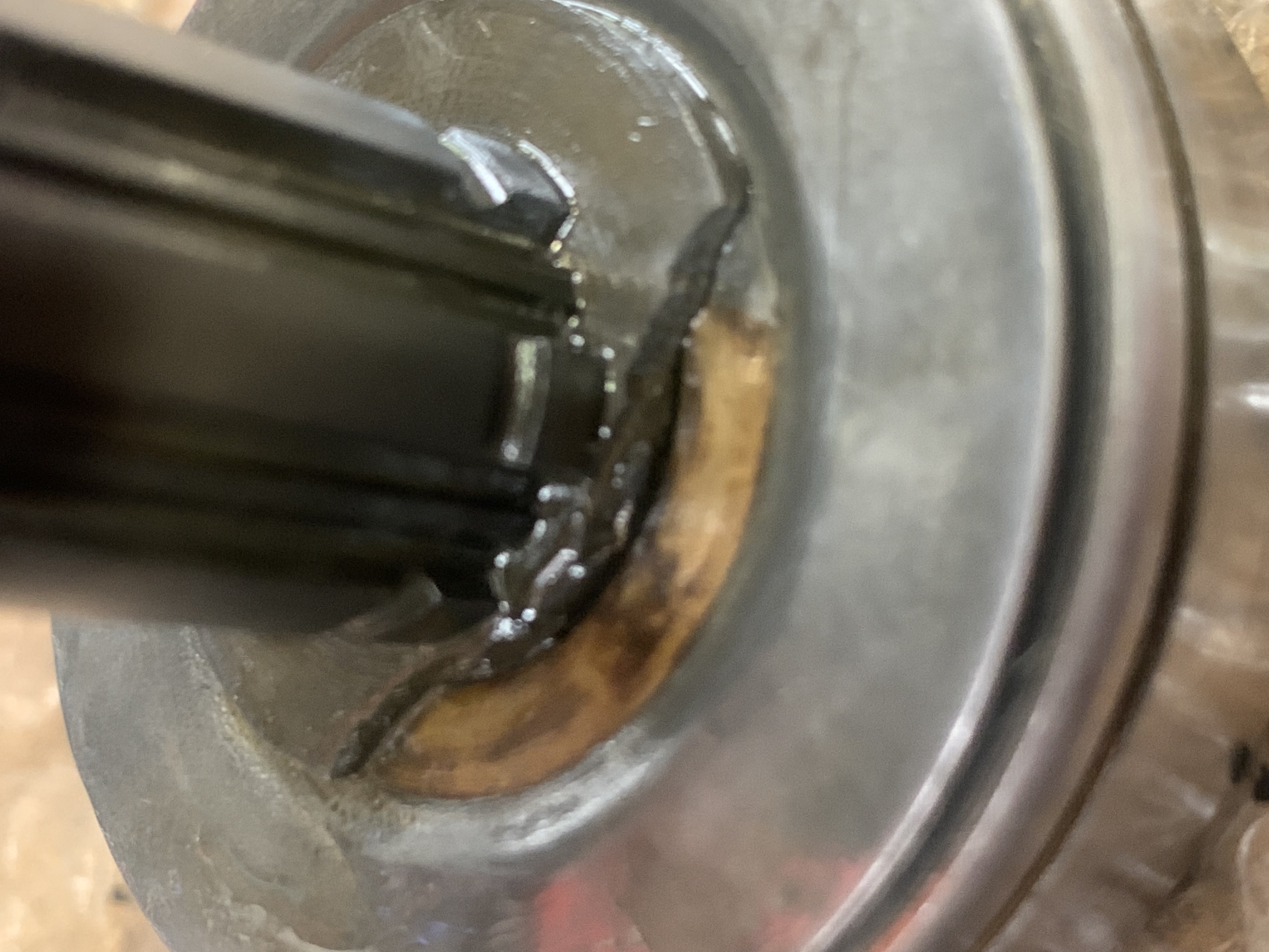

Another issue with this trans…on the input shaft.
There were no loose chunks to be seen anywhere.
No metal pieces on the drain magnet.
Removal of the flange and nut at the output shaft was easy. With that in mind I suspect this has been opened before, cleaned out and put back together.

Lowsy pic. That broken piece is the inside race of the bearing on the spline end of the input shaft.
It comes with this bearing:https://www.euromotoelectrics.com/produ ... ing449.htm
You have to disassemble the input shaft because it can ONLY come off from the other end.
It's broken because somebody tried to pull it off towards the spline end. I know that because a long time ago, in a land far away...oh, never mind. To remove the outer part of that bearing, remove the input seal from the case, apply a little heat, and the outer part should fall out with just a light tap.
You don't really need any special BMW ($$$$) tools for this job. It just takes a bit longer without them. You do need common sense however; don't force anything. You can pull old bearings you're replacing off by their outside edges, but only apply pressure to the inside races when installing the new ones. If something appears seized, apply a bit of heat. A generic bearing puller kit (and a padded jaw vise to hold things) and a bunch of generic sockets will get the whole job done.

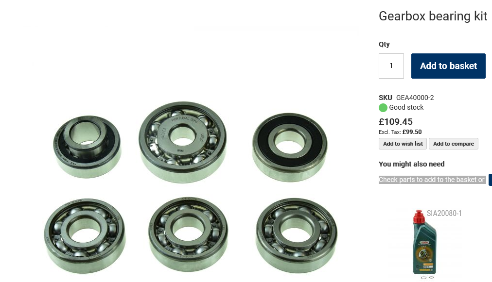

I have a shim plate. My plan will be to assess that output shaft under the front bearing and 5th gear. If that's ok then I'll review costs and decide what to do. My inclination is to fix it with new seals, bearings, springs, 2nd and 3rd gears, maybe a tall 5th but only if that shaft is good enough.
ukp100 from motorworks.co.uk. postage is around ukp45. Less than $OZ300 delivered...add ~ukp40 for the seals and gasket etc...

The bearing kit you pictured has the old style large bearing that requires the spring clip behind the circlip.
The side with the writing on it shouldn't have a taper.
It'll work, but I prefer the other one with no taper and no spring clip.
