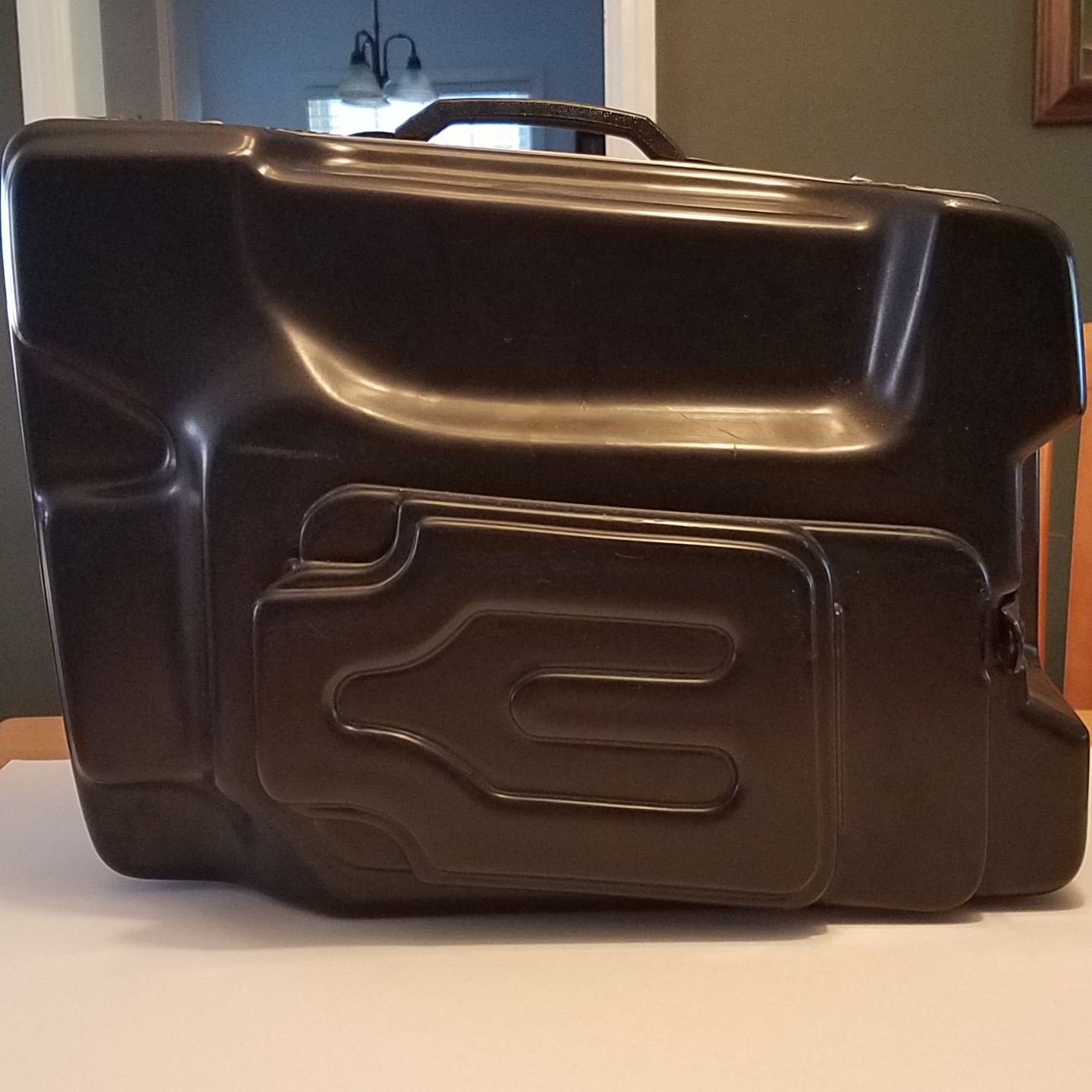

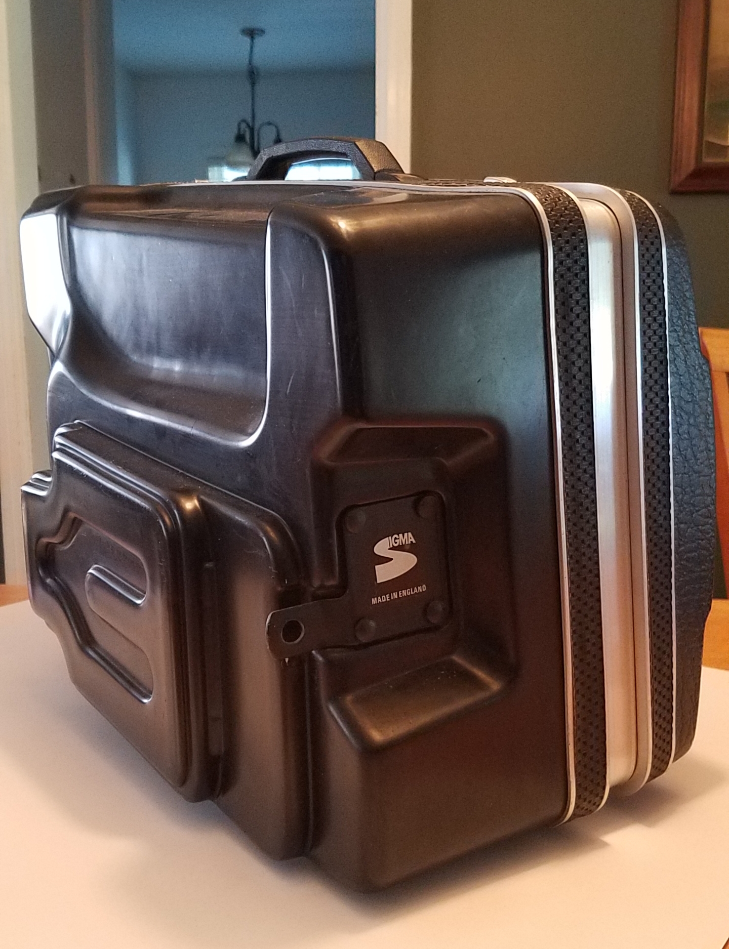

Hello all, I purchased a beautiful set of Sigma hard bags (made in England) on Ebay. Posting stated they came off an early R100, so I assumed they matched up with the standard Krauser mounts. Would make sense because the mounting interface looks identical..ish.
I talked with another guy on Ebay who was listing Krauser mounts, but the inside dimensions were a bit larger than my Sigma bag protrusions. In addition, it looks as if these Sigma bags are locked/latched to the mounts using a different method.
Sigma protrusion dimensions: 12" x 6-3/4' (or 305mm x 171mm)
Looking to find out if there were/are Sigma bag mounts or adapters for the Krauser mounts, so I can use them on my 1976 R75/6.

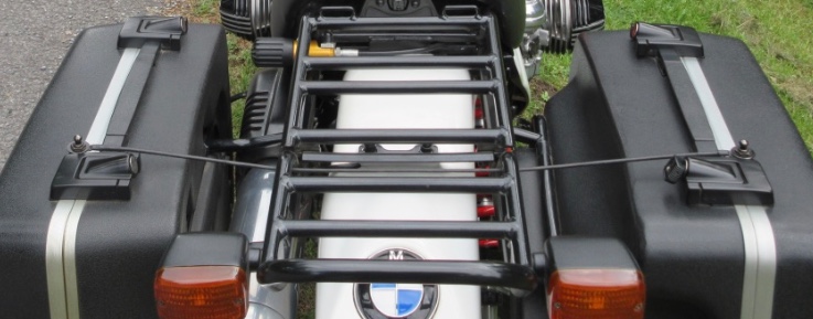

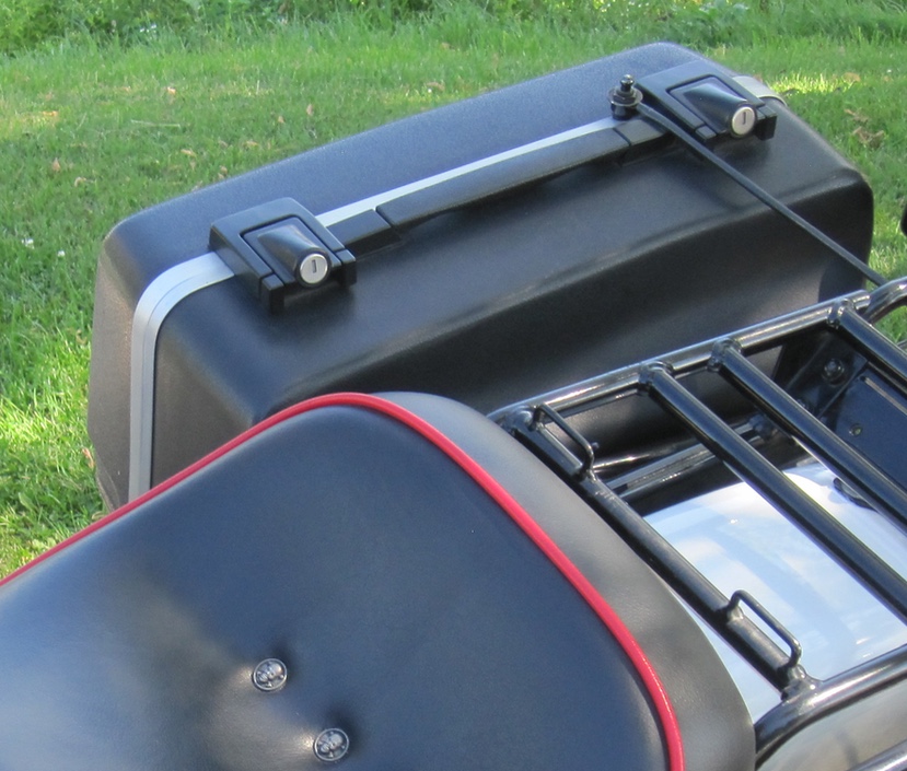

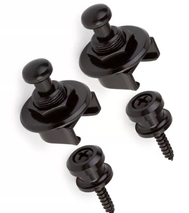

This is my present day solution, a steel cord with guitar strap fittings connecting both lids together.
Regardless of the latching system you choose, have a hardcore backup.
I learned this the hard way when I lost a saddlebag en route three thousand miles from home.
Never noticed it falling off, but in hindsight, I did at some point feel a surge in power from dropping the ballast.
What a nightmare that was, retraced my route for two days with no luck.
It was the bag with all my girlfriends' stuff, so as you can imagine, the rest of the trip was a bit tense.
I never found out if the latch broke or if I inadvertently left it unlocked and it popped open on a bump.

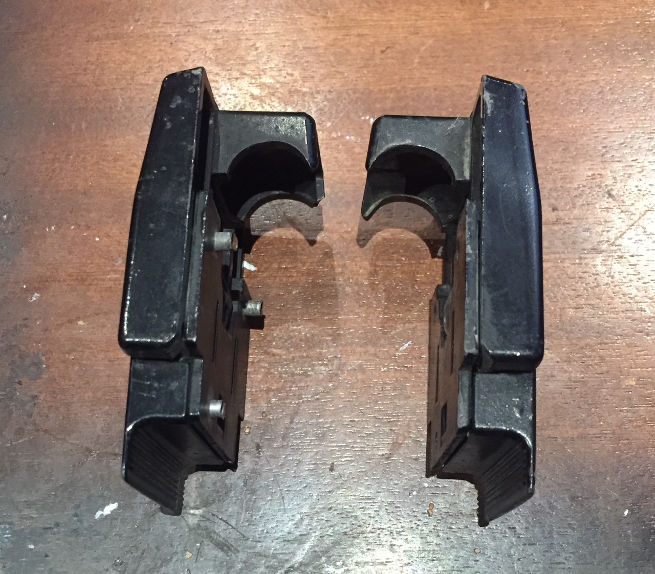

Re: Sigma hard bags mounts?
WasDadsR75_6 wrote: ↑Fri Oct 28, 2022 11:16 am Thanks for the responses. Regarding the "claw" type latches, could you share some pics or part numbers? I've seen plenty of styles online and I'm not sure if the latches attach to the bags, or the frames. These are well used and missing some rubber buffer blocks.
If you buy a pair, you'll likely get two different keys. The locks come with keys. However, if you lose the keys, they're only available if someone has spares.pn 46 54 2 300 008 CASE SUSPENSION CATCH
Case suspension catch, R50/5 - R100GS. This latch holds the bag to the side case holder. When ordering this PN, it comes with a new set of keys. The latch/key number that is received will be random. The key and latch number that is received will be random. Keys for these latches are no longer available.
The later panniers have similar but different locks that look sturdier. I've never used those so can't help with better knowledge. No key barrels in these pictures.
pn46 54 2 315 320 CASE SUSPENSION CATCH (from 04/89)
Case suspension catch, R50/5 - R100GS. Clamps to the backside of the case mounts.
The later Krauser version has very good looking locks. I've never tried to buy those separately though.
