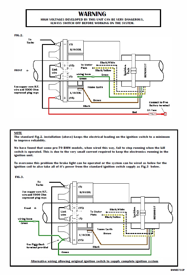

Running on is a known issue with Boyer ignition, so much so that they issued a note suggesting a 'fix'. The original wiring has the positive side of the left hand coil wired direct via a fuse to the battery with the green/blue wire (originally connected to the coil) being used to power the control unit. The revised wiring returns the green/blue wire to the coil and takes a feed from that terminal to the control unit. Attached is the BB wiring diagrams from their original Instruction sheet.
revised wiring.jpg (163.25 KiB) Viewed 1693 times
This sounds very much like the issue you are experiencing... as to why it wasn't happening before, no idea!

The truth is this shouldn't happen when the power is switched off, there should be no path for even the minimal current required to run the unit... however, clearly it happened often enough for the manufacturer to issue the note giving the work around. It is interesting to note that the instructions for later models of BB ignition don't have the coil positive connected direct to battery but connected through the igition switch as in the note. While I understand the reasons for running the coil current direct from the battery, I wouldn't be very comfortable with it since it relies on the electronics of the ignition unit to 'switch' the bike off completely.
In practical terms, rewiring the ignition in line with the note, although it will solve the immediate probolem, will not necessarily fix the parasitic current drain that is causing the issue and I would be troubleshooting the electrical system on the bike to see if I can trace the source of that parasitic drain.

Hi Again, so I have fixed the problem and now the kill switch and ignition key will stop the motor as it should, as to why it was keeping running now after the rebuild (or really re commissioning) I am unsure.
I did some tests but first I should point out that the bike is not fitted with twin coils as per the drawing but a single pack 12v coil with 2 HT leads, would that make a difference I have no idea, so I measured the current draw from the Battery + to the coil on the red connection with everything else off and had a 0.02 amp draw, then I disconnected the Green wire that feeds the electronics box to see if the key was leaking power and letting it run I got a total zero.
So I rewired it as per the second circuit feeding the coil and the electronics from the green ignition wire and it worked perfectly.
As to why it is now different to when I rode the bike 2 miles when I picked up the bike to now is a bit puzzling, could it have been a bad earth or that fuse link (red cable) I replaced who knows, all I know now is it works and I am chuffed.
