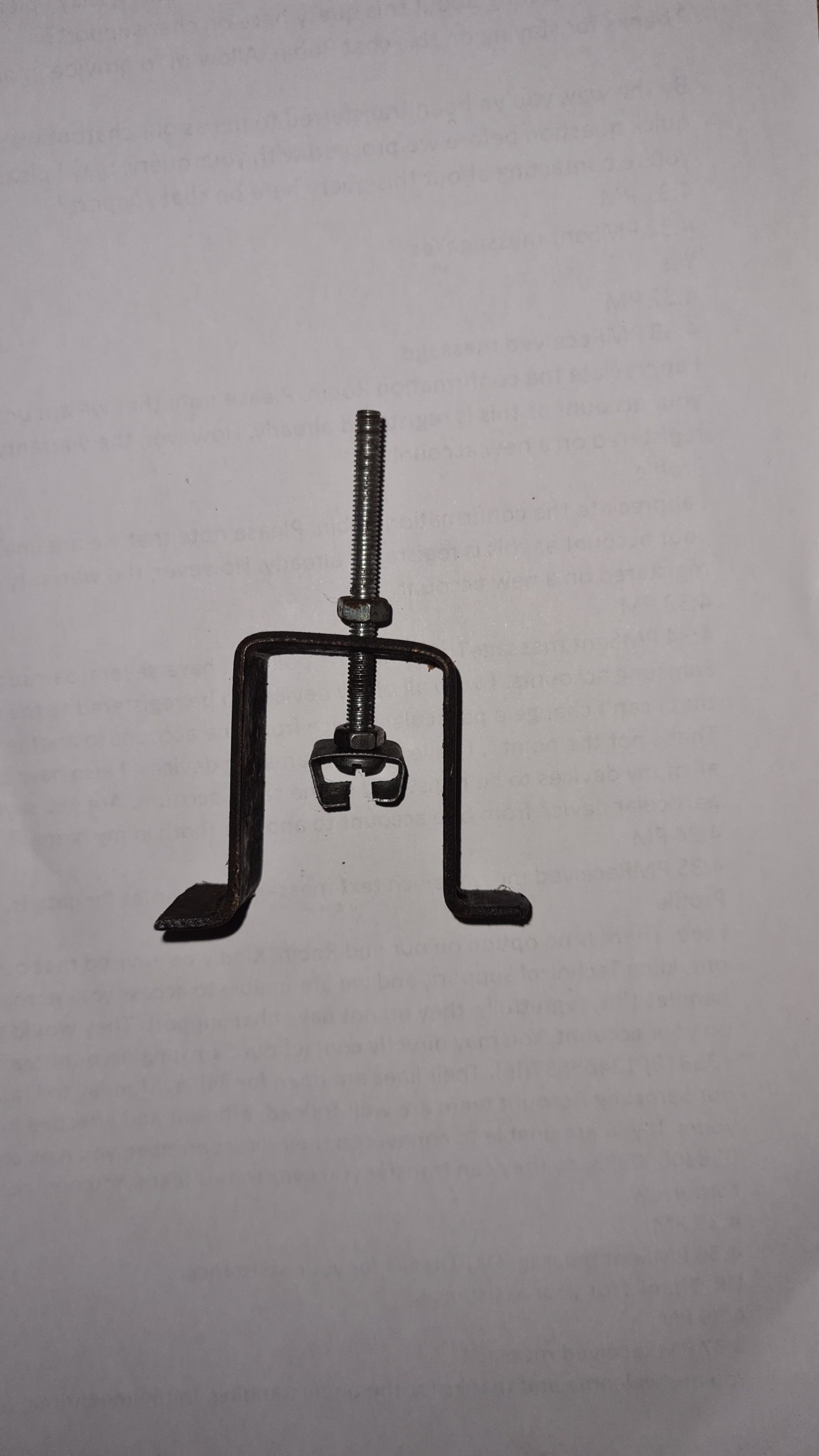

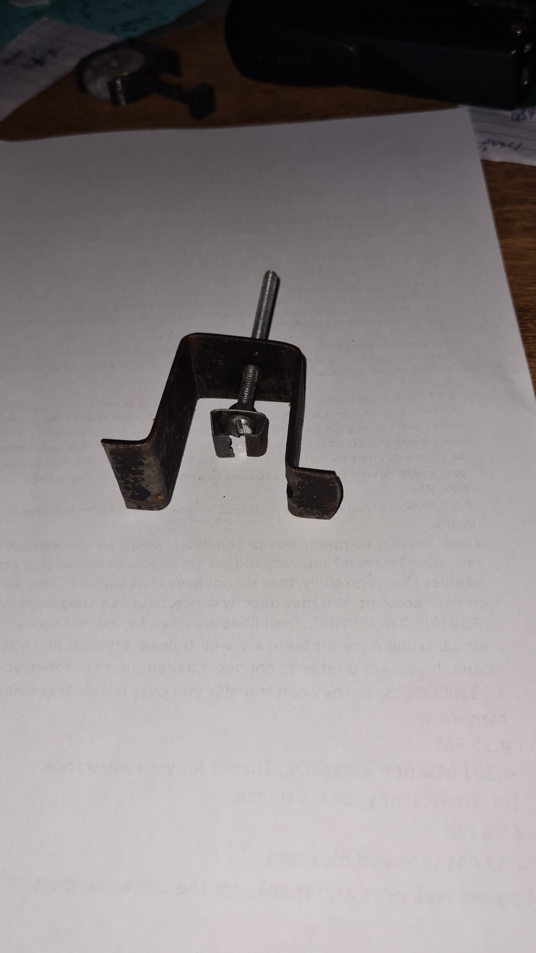

There is a proper tool for the job, made for clockmakers to pull clock hands. Two types, one bears on the central spindle and so is no use for this application. The other is a small two legged puller that has a clip in the middle to fit under the needle boss. Alternatively, it is very simple to make one. Below are images of one I knocked up from odd bits of metal. Very crude but works perfectly. A couple of bits of plastic to protect the clock face, slip the clip under the needle boss and tighten the nut on the rear. It doesn't take a lot of force and it ensures that the pull is perpendicular so that the spindle isn't bent.
Needle Puller2.jpg (706.79 KiB) Viewed 2935 times
Needle Puller1.jpg (741.52 KiB) Viewed 2935 times
