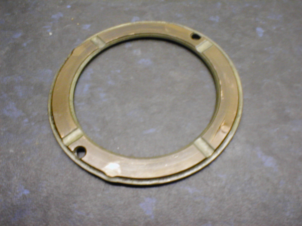

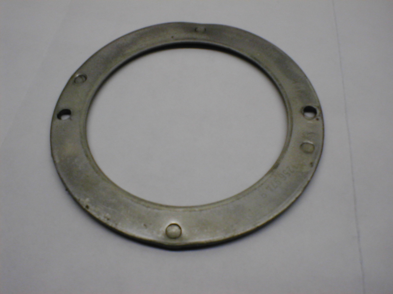

Slightly off topic but not unconnected... whenever you remove the flywheel (or even loosen the bolts), it is a very good idea to block the crank rearwards so that it cannot move It only needs to move a few mm to allow the thrust bearing to come off the pins. To emphasis the point, below are a couple of pics showing a thrust bearing from an engine where the flywheel has been tightened with the bearing off the pins (twice by the look of it). As you can see, it is completely useless.

And Front
