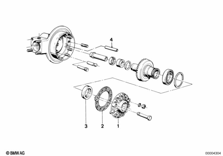

gsm_r100rt wrote: Tue Aug 12, 2025 12:57 pm Is it another seal within the final drive hub?
Yes
Re: 1982 R100RT Final Drive Oil Leakage
#2 is a seal. pn 33 12 3 004 337 newer alt part # Shaft seal ( 30.42.7 )
#3 is a needle bearing pn 33 12 1 242 739 NEEDLE BEARING - 32X47X24.5
#4 pn 33 12 1 230 527 COMPRESSION RING - 1,8MM
#3 is a seal 33 12 1 233 528 SHAFT SEAL - 65X85X10

I think it's almost certain to be the inner drive seal, the smaller one that locates in the main casing (#3 on the upper of the two diagrams posted above). Unusual, it's normally the big one that goes first. Replacing them is not too hard and, since you aren't disturbing the pinion or replacing running parts, you should get away without adjusting the backlash. Worth checking it before you start though.
The only 'unusual' (rather than special) tools you need are a couple of longish bolts... 6mm if memory serves. There are two threaded holes in the inner cover. Two suitable bolts will enable you to draw off the cover with the minimum of fuss. Best if the bolts have rounded ends where they will press against the outer cover.
