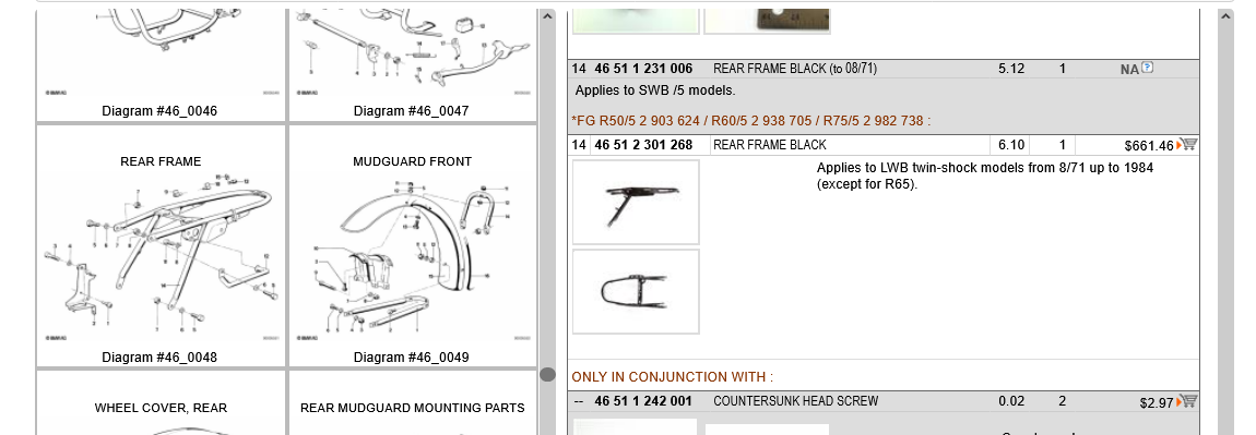

Re: '73 R75/5 Early SWB and Late LWB Questions?
Have you tried the fiche and input your vin number.
https://shop.maxbmw.com/fiche/PartsFiche.aspx
www.realoem.com
If you're looking for a specific lwb part then your suggestion of using the /6 list would likely work. It does also give a cross reference list too.
If you look via 75/5 inputs, you might see the fiche gives a to-from date for parts that have changed. You'll need to look in the parts list for that particular parts picture to see the differences.

Thank you for that example. I have looked at parts lists that show a date from - to. Like in your example, they show SWB up to '71, then LWB '71 on. My SWB is frame tagged '73. So If I bought that part by year, I would have ended up with a LWB rear frame. So it's a bit confusing when I have a early '73 SWB and a late '73 LWB.
Now with the SWB vs LWB. I would need to look at the pics again, but my LWB may be the mid LWB. It has the welded in section rather than the one piece long.
Thanks again!!!!!
