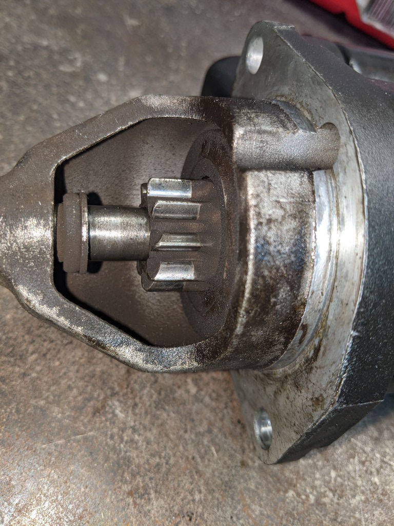

So below see pics of the original Bosch starter teeth.

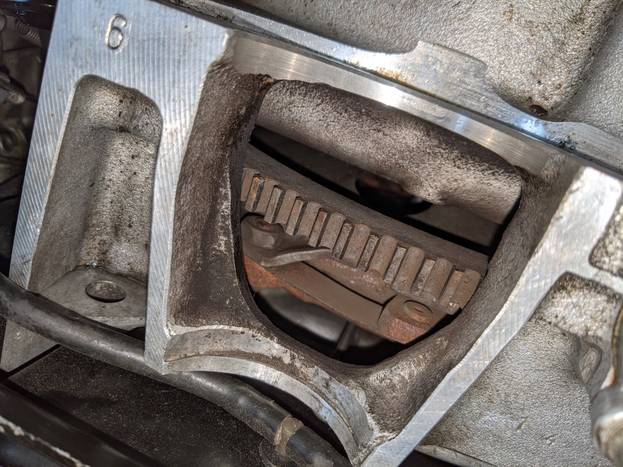

Also see my flywheel.
I'm interested to know:
If the teeth on the original starter/flywheel look good to you.
Should I clean the flywheel teeth? How do you do this?
What lubricant should I apply, and if I apply to starter teeth, and or flywheel teeth. Same moly lube as input shaft...or what?
Thanx in advance :)
Re: So here's my starter
YES
NO
NONE. Just put a drop of oil on the shaft the gear runs on

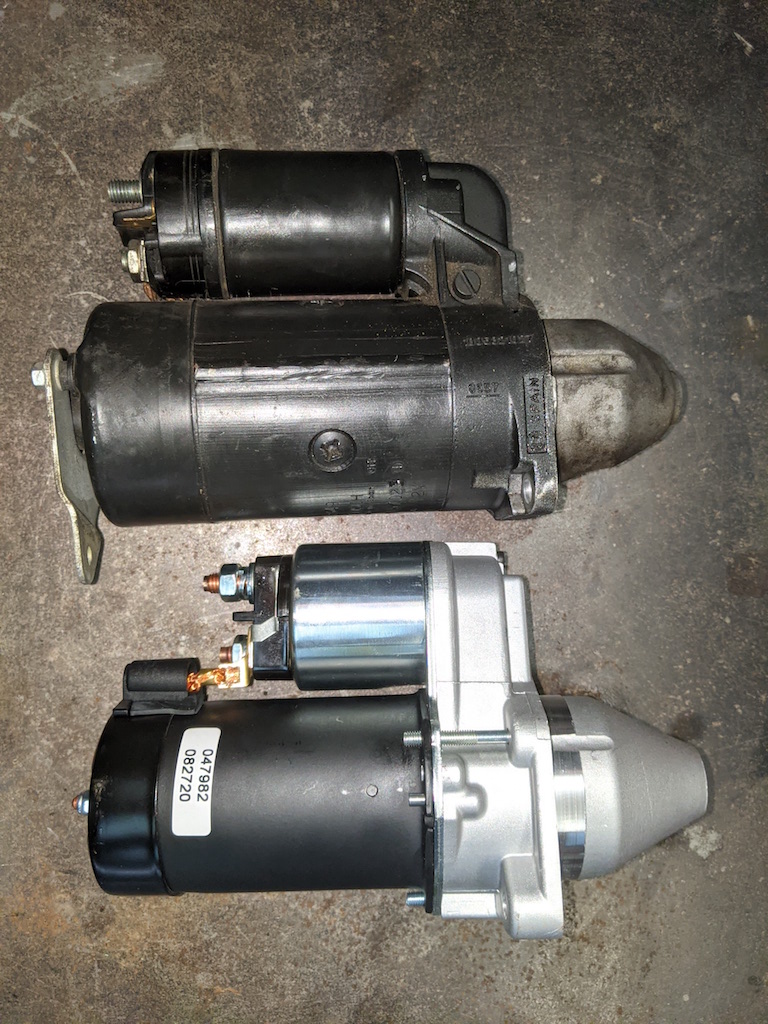

Just got my new starter. Cost me $112 CDN delivered 2days.
Much lighter and looks to be nicely made.....we'll see.
I just installed the mother of all powersport batteries (500 CCA), so this will compensate for the additional weight.
First thing I notice is that the screws thread into the starter casting instead of using a nut.
1- Make sure the new starter has the same number of teeth as the old one.
2 - You don't need that front bracket anymore
