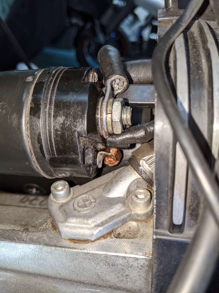

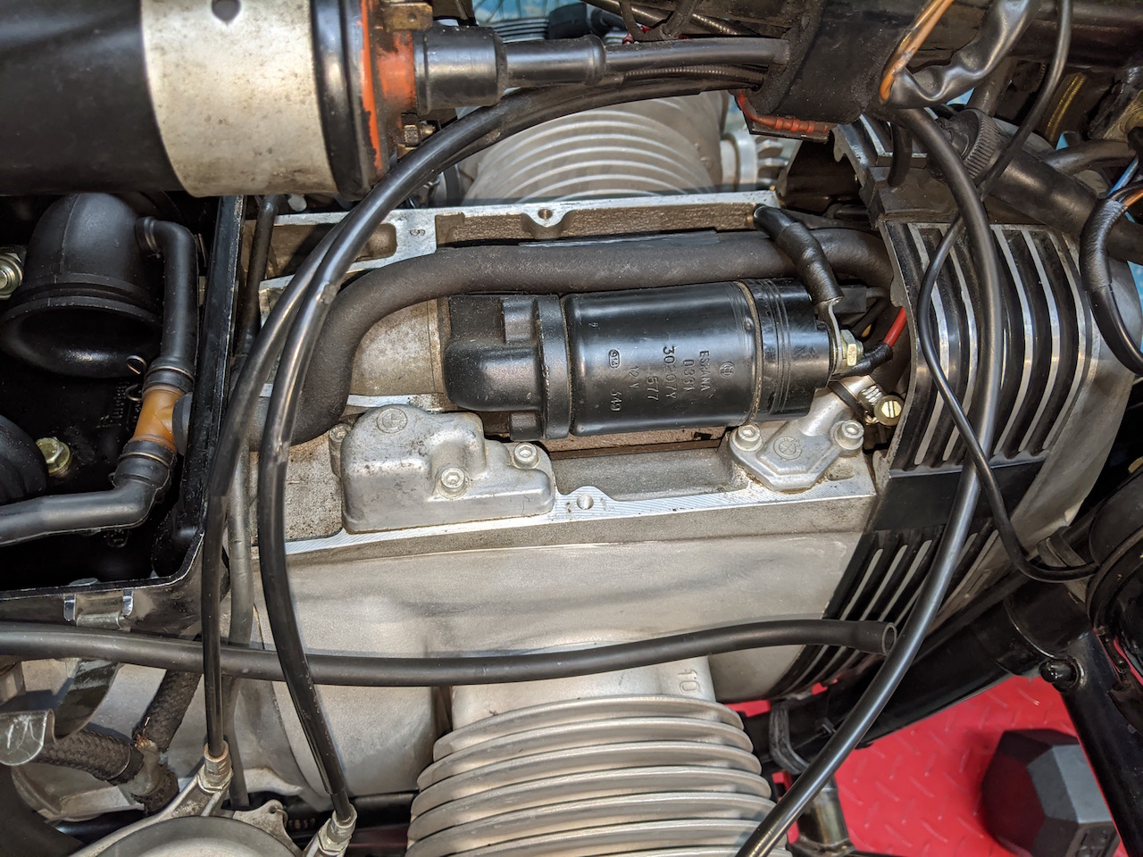

So here's my starter
R100 1984 I think it is a Bosch. Made in Spain.
So before I remove it, are there any tests I can do. :?:
So I'm not seeing anything corroded. Do you see anything?
My book says I have to remove the diode board to remove it. Is that so? (Yes I disconnected my ground.)

Re: So here's my starter
Not sure what's wrong with your starter, but it can be tested without removing it.
If it needs to be replaced, the front mounting fasteners can be a bitch to access, that's why sometimes it's better to remove the diode board and go from front to access them. Depends on the model. and your dexterity.
With a test light.... the small black wire on the solenoid should have power when you press the starter button.
Want a test that is independent of the actual bike? A test that will rule out ALL wiring, battery, switch or relay (possible) issues, and just confirm beyond a shadow of a doubt if your actual starter is working correctly?
1 - Disconnect the small black wire from spade terminal on the solenoid.
2 - Get your car and some booster cables.
3 - Hook up the positive from the car to the main power wire (the big one on top) on your starter.
4 - Negative from car goes to a solid ground on engine case close to starter.
Not necessary to have car running
Now, jumping the power (with a screwdriver or similar implement) from that 'main wire' to the 'solenoid spade terminal' will activate the starter (if it is good).
Thanx C! Would the intermittent nature of my problem be exposed, while testing with the starter in the bike?
GSPD suggested a method to test just the starter, isolated from the from the bike, while still installed, boosting from another battery.
The intermittent ability to start normally is very confusing.
Removing the starter is not going to be easy from the looks of it:(
I replaced the starter relay with no change.
I have a new power cable that goes from the positive battery terminal to the solenoid. I'll replace that as part of this process. I don't see any problem (corrosion) with the old one.
At this stage it's time to take the motor out and at least give it a good going over. There is a strong probability that the fault will be with the rotor or with the solenoid and you aren't going to be able to find out which with the motor in the bike. It is possible to get it out without removing the diode board but it's an unbelievable faff and I would always remove the board now. It's only four nuts and a few wiring connections... if you're worried about the wiring take notes and/or attach labels to each wire. There are, of course, other possibilities but, if the solenoid is activating, which it appears to be, then the chance that you are going to find/fix the problem without removing the motor are vanishingly small.
Thanx Rob!
When you remove the diode board, does the starter come out towards the front of the bike, where the diode is removed?
No, the starter lifts straight out of the bike. You need to remove the diode board to get access to a bolt that secures a steel plate support for the rear of the motor. Once that bolt is removed (and everything else is disconnected), you can simply lift the starter out of the top of then engine. One of the benefits of the later Valeo motor is that, being lighter, it doesn't use the support at the rear of the motor so the issue doesn't arise. Probably fortunate given the unreliability of the early Valeo starters :).
I was able to access the M6 (10mm hex head) screw that holds that steel plate to the engine case through a hole in the engine case after moving the wires from the alternator just a bit out of the way. This was on both a /6 and a /7. Your results may vary.
I don't see any way to get to both nuts that hold the starter to that steel plate other than maybe a ratcheting crow's foot distributor style bent wrench.
melville wrote: Sun Jan 31, 2021 12:05 pm
You don't really need to... once the bolt into the crankcase is removed, the starter will lift out with the bracket attached. The biggest nuisance is trying to retrieve the bolt when it inevitably drops out as you remove it...
