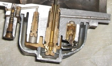

Kurt in S.A. wrote: Sat Jan 08, 2022 11:19 am Does the main and the washer sit within the small detent in the bottom of the bowl? Been a while since I looked at the bottom of the bowl but thought there was a ringed area in the bottom. Could the jet and this bowl area work together in some way?
I've always understood that the washer and the ringed area were intended to work together to keep the main jet submerged when fuel is sloshing around in the bowl. Whether that function is needed or not is another thing.

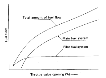

mkj wrote: Sun Jan 16, 2022 10:02 am Today tried again as the weather was not too bad but sadly tightening up the main jet assembly made no difference. Went to get some fuel then tried balancing the carbs with home made manometer but it would not cooperate.
I don't see how the main jet can have any impact at all on a manometer balance at idle or at the usual figure of 2000 RPM to check throttle cable synch. The engine needs to be under load and at a minimum of 3000 rpm before main jet size has much impact and even then it has to be several sizes out. There is no point in attempting a cable sync balance if it won't balanced at idle as the fuel flowing through the idle circuit is still additive to the main circuit. It might be there are two problems but it sounds like there is one in the idle circuit.
