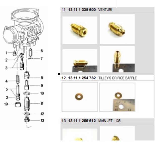

The main jet washer has an interesting history.
https://en.m.wikipedia.org/wiki/Miss_Sh ... 7s_orifice

I'm not at all sure that this is a 'Miss Shillings Orifice' AKA Tilly's Orifice' or RAE restrictor. The restrictor was in the form of a washer with a set and carefully calculated diameter hole set in the fuel supply line to the carb on the Merlin engine aero engine. It's purpose was to restrict the flow of fuel to the float bowl under negative G conditions and prevent loss of power when the aircraft was set into a dive. There's no way that the washer in the bing carb meets that description... and, in any case, why would anyone fit a precaution against negative G in a bike carb... so what's it all about then?
I believe the washer is there to help prevent air entering the main jet as a result of repid fluctuations in the fuel level due to vibration and uneven road surfaces. This is just my take and I could well be wrong but I can't see any other reason for it.
