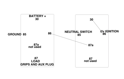

Rob F, are you home?
Re. my previous post...The goal of this exercise is:
1 - Direct battery power via relay to hot grips and auxiliary socket (done)
2 - LOAD turns ON with ignition ON, and OFF with ignition OFF so grips can't accidentally left on when bike is parked (done)
3 - (the clincher) LOAD has to turn OFF when ignition is ON ONLY WHEN neutral light is ON. I think I can accomplish this relatively easily with 2 cheap relays.
My question for Rob: Can this be done with only one relay? If so, can you please elaborate?
I would like to use generic (cheap $3.00) 30-85-86-87-87a relays that I can get locally, not a special (expensive) relay that I would have to order.
This is how I would do it with 2 relays:
2 relays.jpeg (18.07 KiB) Viewed 1689 times
Posts: 1376
Re: Hot grips, install a relay, winter's coming!
Nope, can't think of any way to achieve what you want to do using a single relay on it's own. I could do it using a simple semiconductor circuit to reverse the sense of the neutral switch (which is effectively what you are doing with the second relay) but that doesn't fulfill the specified conditions.
Rob Frankham wrote: Sat Oct 22, 2022 12:20 pm Nope, can't think of any way to achieve what you want to do using a single relay on it's own. I could do it using a simple semiconductor circuit to reverse the sense of the neutral switch (which is effectively what you are doing with the second relay) but that doesn't fulfill the specified conditions.
Ya, thanks Rob, that's what I thought, but I wanted your opinion just to be sure. :geek:
Sooo.... I taped 2 relays together and wired everything up and it works perfectly.
I'll pretend it's just one big $6.00 relay. :lol:
