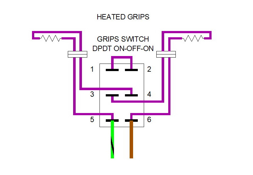

With a double pole, double throw switch you can switch between parallel (12V) and series (6V) to power the grips:

Airbear wrote: Sat Oct 15, 2022 7:43 pm With a double pole, double throw switch you can switch between parallel (12V) and series (6V) to power the grips
Thanks Airbear.
Sounds like a plan. Are there any downsides to doing it as you illustrated?
Sounds too easy. What's the catch?
EDITED THIS PART BECAUSE I'M HAVING BRAIN FREEZE
So the grips connected in series should put out about half the heat as when in parallel? Is that correct?

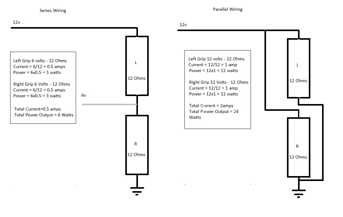

I'm afraid that there is a flaw in that way of wiring things. I have done a quick generic wiring diagram to show why this isn't going to work well. I hope it is self explanatory but, in principle, arranging the loads in series will actually reduce the power output by to one quarter of that if the same loads are arranged in parallel. Please note that the figures aren't intended to represent any particular heated grips, just to show the way in which power output is affected by way the loads are arranged. In fact, the figures were chosen so that the arithmetic is simple...
Actually, the situation works for constant resistance loads but is over simplified for heated grips because of a phenomenon known as the 'temperature co-efficient of resistance' of the material used for the heating elements. As the temperature of the element increases, the resistance also increases which means that the power increase with voltage will not be linear. In effect the power output of our elements linked in series will actually be somewhat higher than 25% although it's highly unlikely to be anywhere near 50%. It depends on the material chosen for the elements.
There is also another factor to consider... If the elements are designed to run in series at 6 volts, feeding them with 12 volts is very likely to considerably shorten there life.

Rob Frankham wrote: Mon Oct 17, 2022 8:28 am I'm afraid that there is a flaw in that way of wiring things. I have done a quick generic wiring diagram to show why this isn't going to work well. I hope it is self explanatory but, in principle, arranging the loads in series will actually reduce the power output by to one quarter of that if the same loads are arranged in parallel.....In effect the power output of our elements linked in series will actually be somewhat higher than 25% although it's highly unlikely to be anywhere near 50%... If the elements are designed to run in series at 6 volts, feeding them with 12 volts is very likely to considerably shorten there life.
Thanks a million for the explanation Rob, you saved me a ton of wasted time.
Airbears' schematic seemed too damn perfect, and it is for certain applications, but I couldn't understand why it wasn't universally used in all grip applications if it was so good. Why would most manufacturers use resistors or resistor wires to provide a lower heat setting? I thought that if parallel was full power, series would be half power, but now you say it's closer to 1/4, and I'm confident you know what you're talking about.

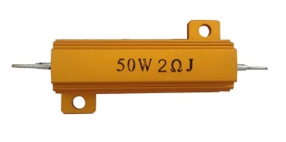

5 - My solution for now would be to substitute my current push button on/off switch with a two position mini spdt toggle switch, with one position providing full 14v power and the other position running trough a readily available heavy duty 50W 2ohm resistor like this:
50w 2ohm.jpeg (9.27 KiB) Viewed 1681 times
2 questions:
1 -Would this resistor drop the voltage from 14V to around 9 or 10 volts, which is what I need, and would it negatively affect increase actual power consumption.
2 - Would it need to be mounted on a heat sink plate or would it cool adequately if it was just hanging in the air on its own.
