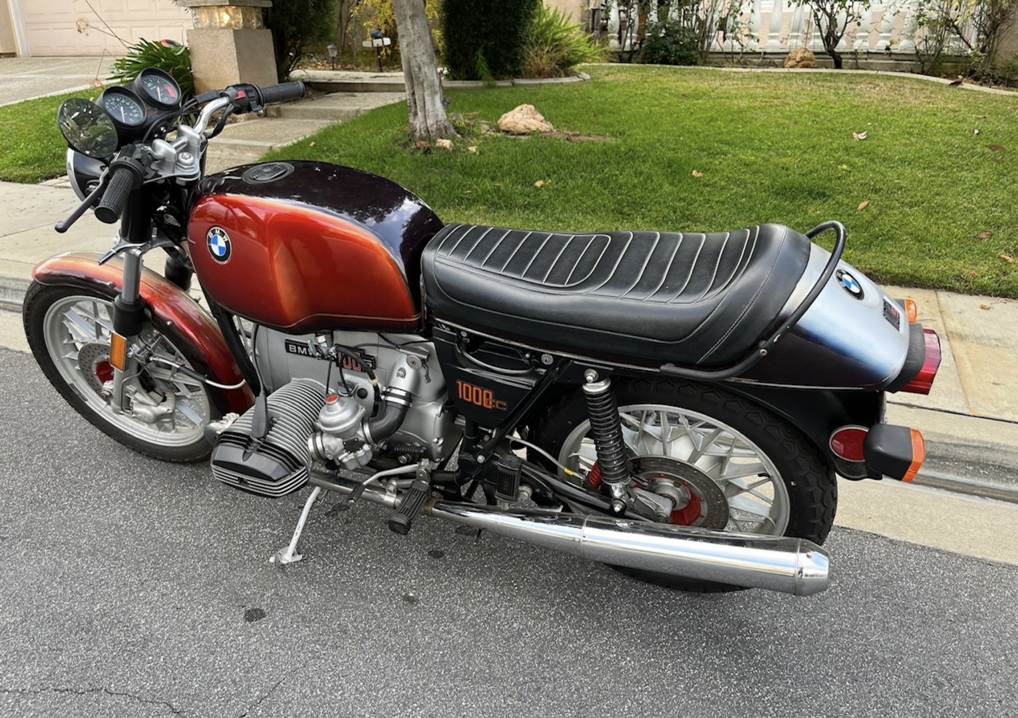

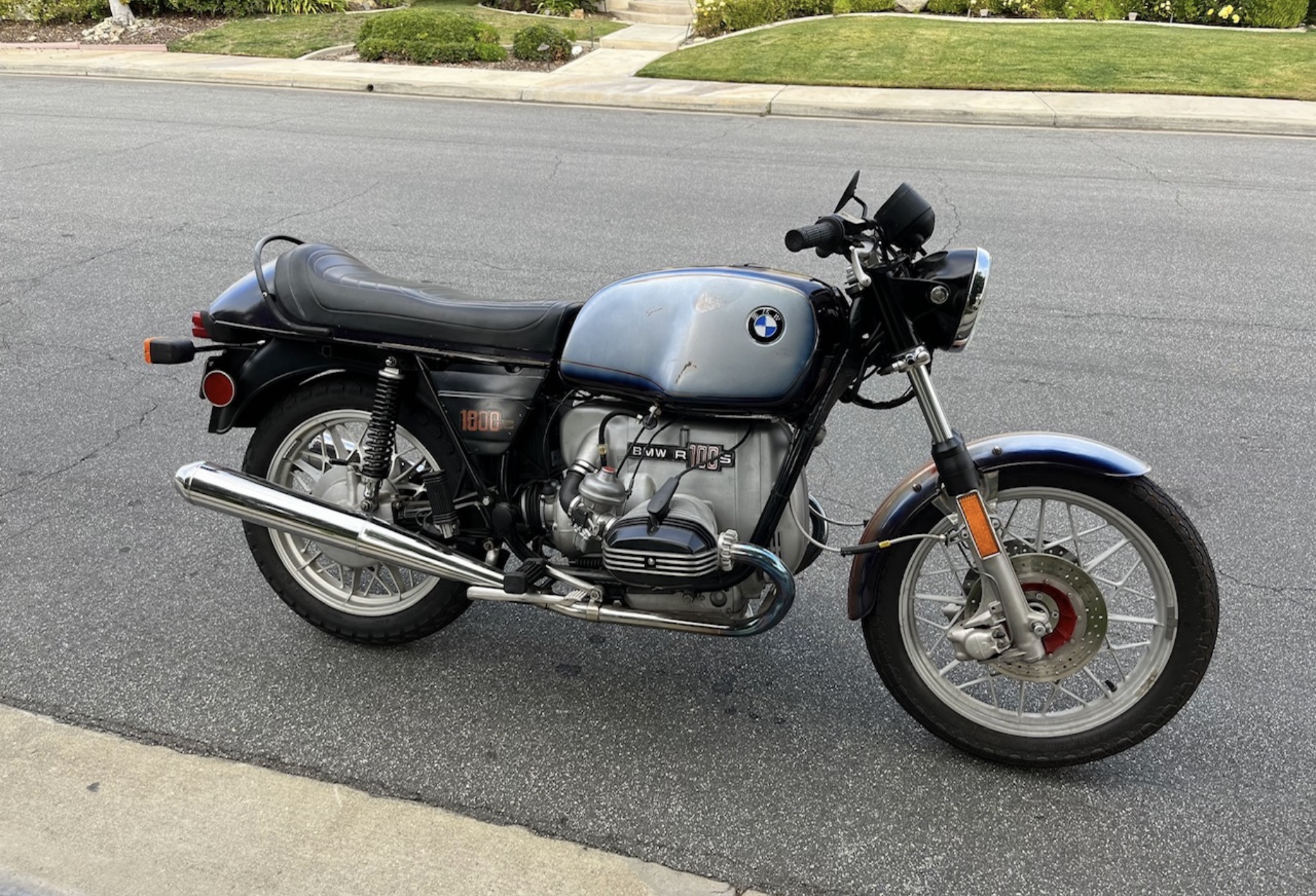

Adding a couple of pics from the day of purchase (6 months ago) while deciding to buy or not..
Yes both pics are of the same bike… taken at the same…it had some paint issues
