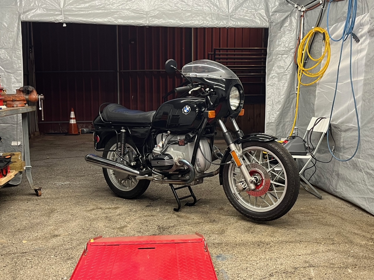

Hi folks
1st post … some photos attached below
Background about this motorcycle:
1978 BMW R100S
Matching numbers
Factory production date 12/1977 According to info found online
Odometer approx 15,000 miles believed to be true
Purchase: 11/2023 locally (Los Angeles) from second owner. (No service documentation supplied). Seller says he purchased from original owner In SoCal in 2021 or so.
Appears to be true low miles bike (15k)
Appears to be factory/stock mechanically except:
Boyer Bransden electronic ignition system installed by a previous owner probably decades ago (BMW - Type MK 3)
I have not touched/adjusted carbs since acquisition…seller said he went to local airhead ‘guru’ for carb adjustments…
Current status:
Runs pretty well
throttle feels subpar
idles ok but only after completely warmed up (1300-1400 at idle according to tach)…yes it’s probably too high.
Handling is good so far…under 60 mph only.
So, I’m about to start the following work and have all parts/materials ready to go:
-not in any particular order-
Check/adjust timing
Check/adjust valve clearances and rocker arm end play
Check for air leaks all around carbs (spray brake cleaner test)
Install new (correct??) spark plugs- BOSCH W5DC (currently NGK BP6ES)
Install new (stock BMW) plug wires
Service/lube throttle control
Install new (stock BMW) throttle cables
Install new (stock BMW) choke cables, service choke lever (airbox mounted)
Disassemble/complete rebuild Bing 40 carbs (all parts from BMW)
Synchronizing carbs
So here’s my problem/question:
Seeking advice as to the best sequence of the above tasks.
My main concern is making sure I have a decently running bike to take those required 5-10 mile warm-up runs prior to some of the tasks. (Will be first time working on Bing carbs)
Have been studying/following Snowbum’s writings diligently (Thank you Snowbum!!)
And also William’s videos from Boxer2valve (Thanks William!!)
MORE INFO:
Work completed by me since acquisition (11/2023):
1. All fluids changed including fork oil
2. Sump pan removed, cleaned and new gasket/bolts installed
3. Air filter (mahle) installed
4. Front brake system (dual disc) serviced/rebuilt including new rubber hoses, MC & calipers rebuilt
5. Front forks serviced (rebuilt) & new factory springs
6. Dual horn system installed, including new harness/ relay/ fuse
7. Factory “S” fairing, nice condition (sourced, previously painted black) installed, factory volt gauge & clock (like new) sourced, & custom (by me) quick-disconnect harness with connector
8. Installed front turn signals/correct wiring
9. All new bulbs installed (except not inside instrument cluster)
10. New fuses installed in headlight bucket
11. Sorted/checked connections in headlight bucket
12. All known grounding connections on frame sanded cleaned up
13. New starter relay & new voltage regulator installed
14. Many assorted rubber bits/grommets/washers/bumpers/rings/etc replaced
15. Luggage mounts (Reynolds) installed
16. New gloss black paint work by outside shop (tank, seat, fr fender & side covers)
Cheers
JC

The very first thing should be a compression test to establish what you're working with.
"Odometer approx 15,000 miles believed to be true."
hmmmmm.....
The bike actually looks really nice, please excuse my skepticism.
