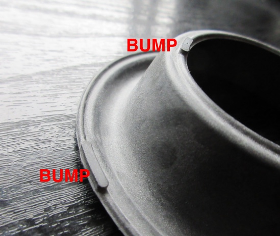

That makes ABSOLUTELY no sense to me. How do you "disable the diaphragms", and why the hell would you want to? Please enlighten me. I'm assuming you are aware that the diaphragms have a "bump" on their inside diameter that engages in a notch in the slide, and another "bump" on the outside diameter that engages in a notch in the carb body. (pic below)

What I interpret from this is that you are uncertain if the diaphragms were installed correctly and that they are possibly perforated. Check them and let us know. The carb will never function properly if those notches are in the wrong place or if there is even a tiny perforation. The notches assure that the slide is EXACTLY where it must be.

These are flat tops so the diaphragm is secured with a plastic ring. To Get the orientation right when fitting the diaphragm make sure the air hole in the bottom of the slide is positioned nearest to the butterfly. This hole communicates venturi vacuum to the top side of the diaphragm and is therefore responsible for piston lift. If the diaphragm is fitted 180 deg out then the hole will not see the correct vacuum signal which will affect lift.
