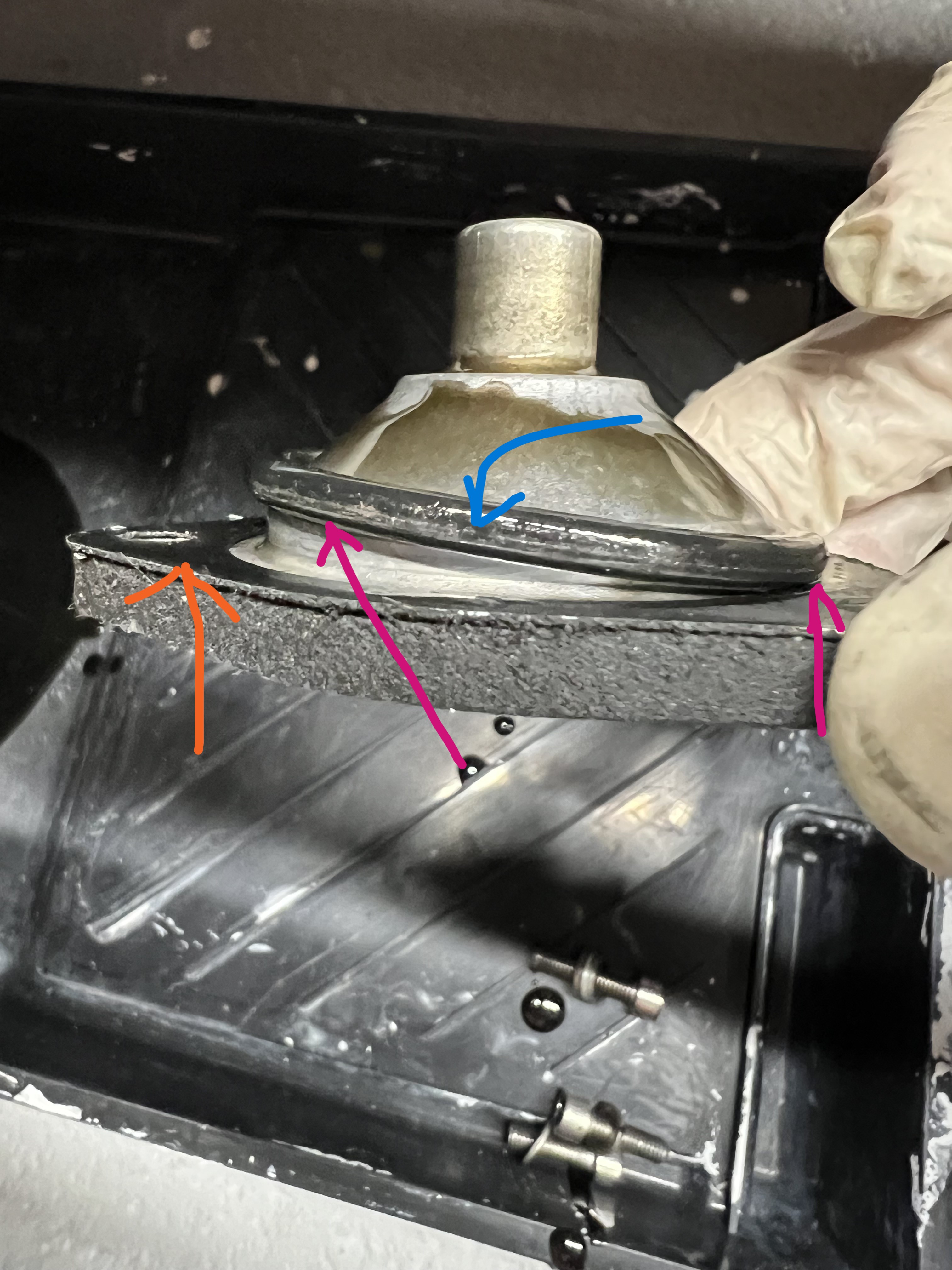

SteveD wrote: Wed Jun 19, 2024 7:34 am Image
That o-ring isn't compressed at all and should be after a few 1000miles.
I thought that was a shim under the black o-ring in your pic :?: Eyesight might be defective. :geek: If so, it should be on the other side if needed for the year model. Apparently not though.
Understood. That’s the gasket which so I’m told is not required along with the shim on post 1990 machines.

As has been mentioned, the various components used in the filter housing depends on how far inside the engine the canister is. The white o-ring (not sure about the back o-ring) is 4mm in diameter. If the gap between the case and the canister is 3mm, then the o-ring would be squeezed from 4mm diameter to 3mm diameter or 25%. That is the upper goal for this setup. If however, the gap is 3.5mm, then the o-ring will be squeezed to 3.5mm in diameter which is around 12%. This is a good lower goal. If however, the gap is less than 3mm, then the o-ring will be over-squeezed and it could rupture. If the gap is larger than 3.5mm, then the o-ring won't be squeezed enough and the oil pressure in the system could be compromised.
So depending on your canister depth, a stack up of components can be determined. If as you say you had no metal shim and the o-ring wasn't distorted at all, that suggests that your canister is deeper than standard. Or it could just be the gasket which effectively reduces compression of the o-ring. In fact, my calculations show that with just the o-ring and the gasket, and with a 3.5mm canister depth, the o-ring has a 0% compression.

mralistairjones wrote: Wed Jun 19, 2024 7:46 am Understood. That’s the gasket which so I’m told is not required along with the shim on post 1990 machines.
It might be an shadowy illusion to my eye...pink looks like a shim. Orange is gasket, blue is o-ring...but you knew that ;)

SteveD wrote: Wed Jun 19, 2024 8:49 am
That is an incredible observation, and if I did not know better then I would have agreed with you that was a shim. However, it must just be how the photo was taken because there honestly was no shim fitted.

mralistairjones wrote: Wed Jun 19, 2024 5:16 am
@barry
In reference to your advice of feeling for 'some resistance before the cover fits flush' in your previous post. To my feel, when I hold the cover in place there is no resistance ... in fact it appears to me that the cover fits flush with the engine casing immediately.
There is your problem then, the O ring wasn't being compressed at all.
Remove the gasket and try again. You should then feel some resistance. If it's Ok replace the filter and reassemble without the gasket. use the new white O ring that came with your filter.

I like this plan Barry, thank you. I just measured the distance between the engine casing and the cannister, the measurements average 3.5mm.

Given that you see 3.5mm on the canister depth and with my math earlier, no gasket, no shim, and white o-ring should get you reasonable squish of the o-ring. Monitor the amount of resistance you get when reinstalling the cover without filter as Barry has said. If you see that it takes something of a push to get the cover flush to the case, then insert the filter and put it all together.
