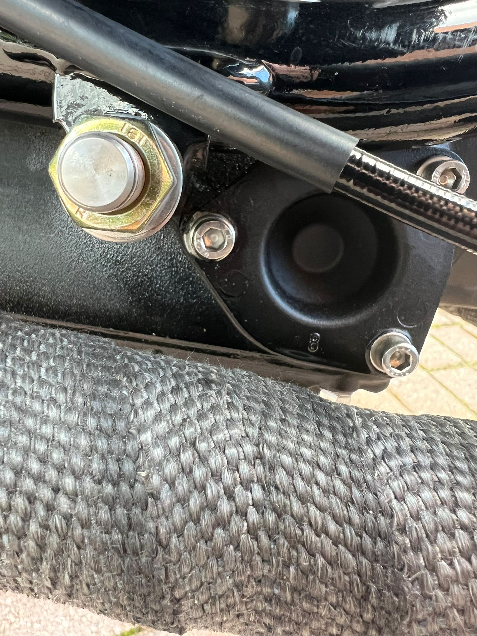

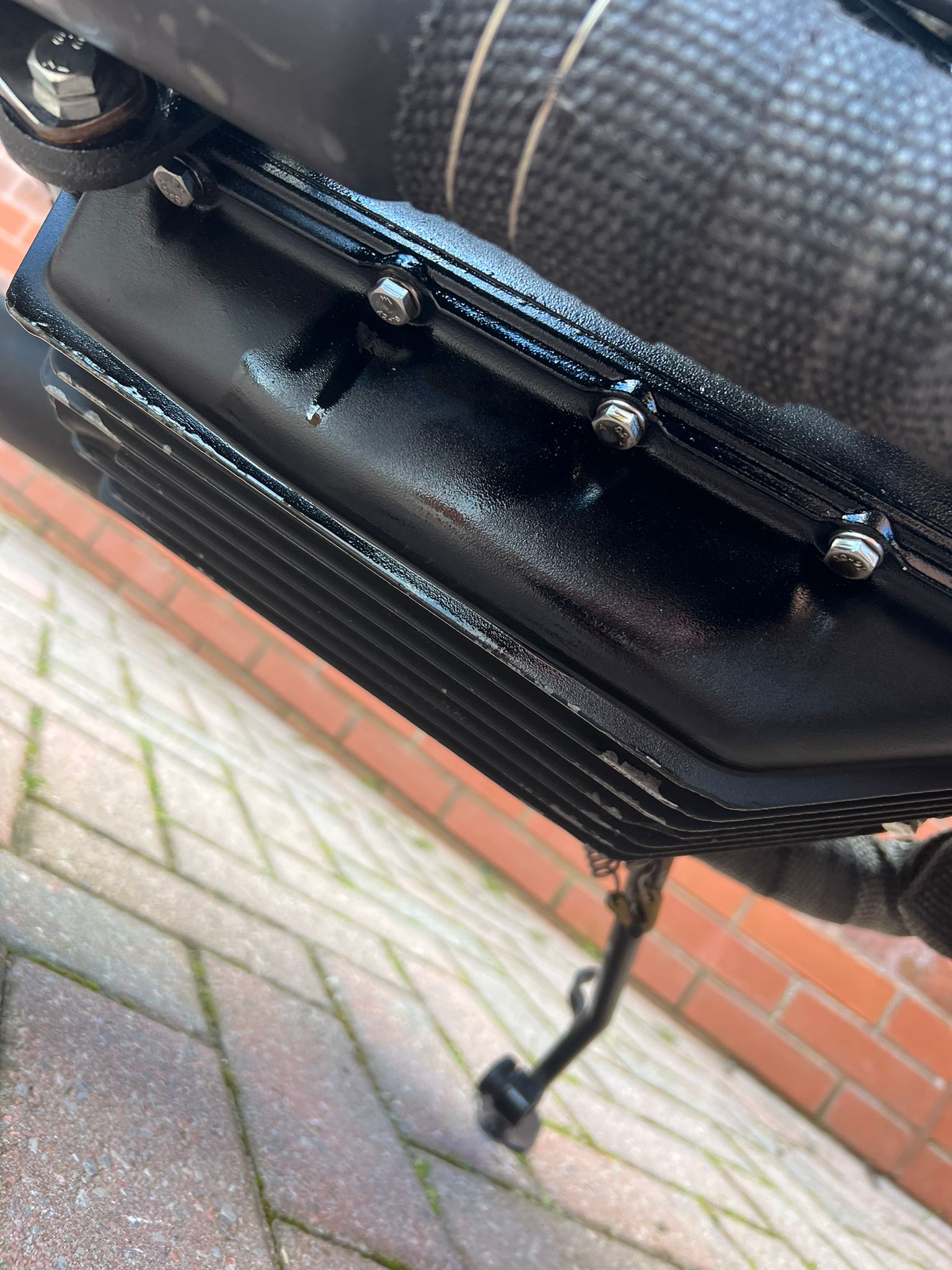

I have noticed recently that around the oil filter cover (which has not been removed during my ownership) there is oil leaking (evident after a 15 minute rideout), not a great deal but leaking nonetheless. The attached images show what I can see. It looks to me like the oil is coming from under the area of the leftmost bolt of the filter cover and then running down to the bolts holding the underpan on.

I am in receipt of a filter kit and I'm prepared to (for the first time) change the oil, filter etc. but I wondered if anyone could advise what may be going on under the filter cover.

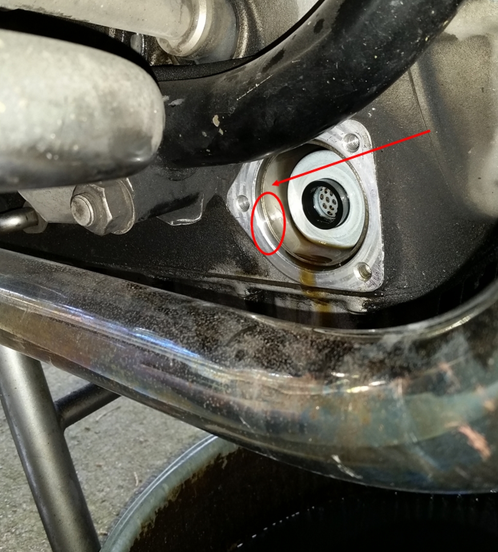

Nominally, the late model Airheads only required two items besides the filter in the housing - a thin metal shim and a large white o-ring. With the cover off, you probably will see something like this on my /7. What I'm pointing out on the image is the canister which is a separate part inside the engine case. It's supposed to be 3-3.5mm inset of the edge of the engine case. The cover is supposed to press and squish the white o-ring to create a seal for the filter operation.
If the distance is less than 3mm then a paper gasket might be needed. The gasket doesn't really seal like a gasket, but acts as a spacer to move the cover out so that the white o-ring isn't squished too much.
Try and remove the cover and let us know what you see.

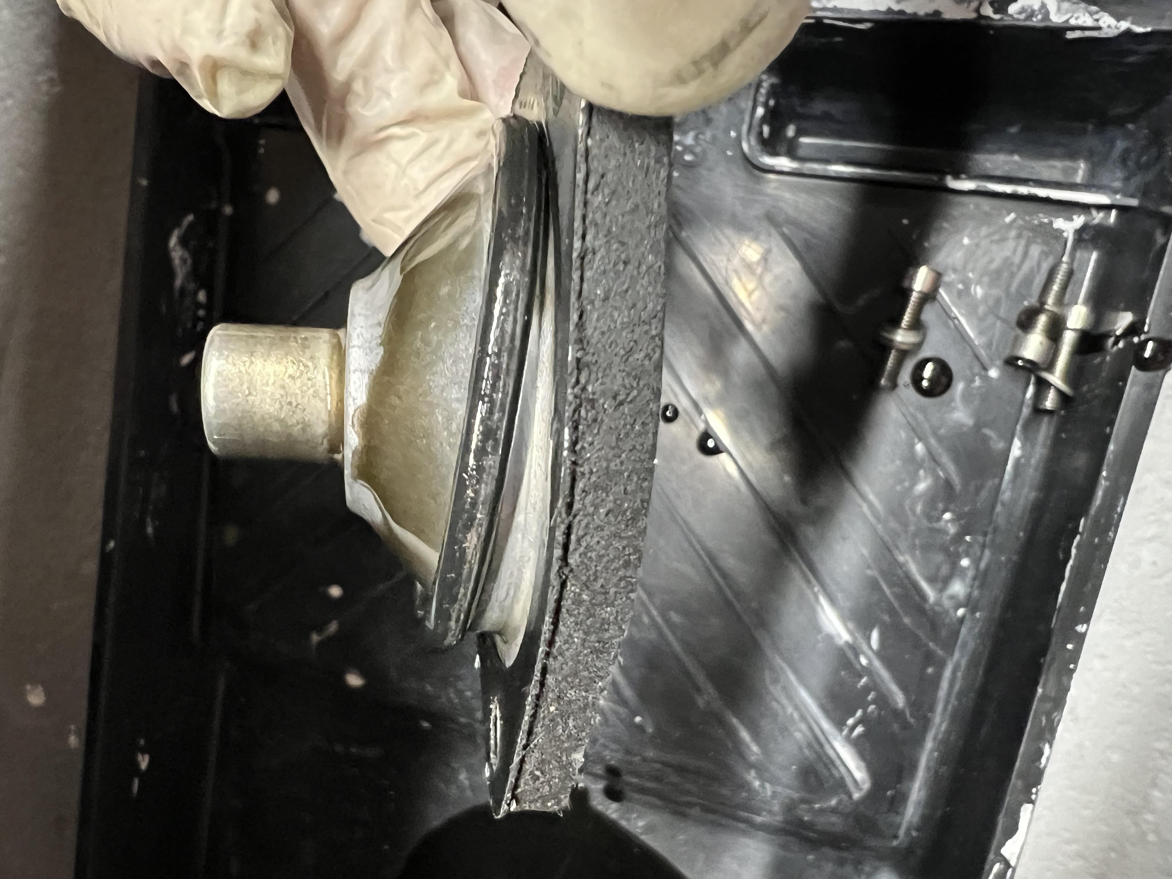

Good evening gentlemen.
This is what I found.
I am holding it as it came away from the engine.

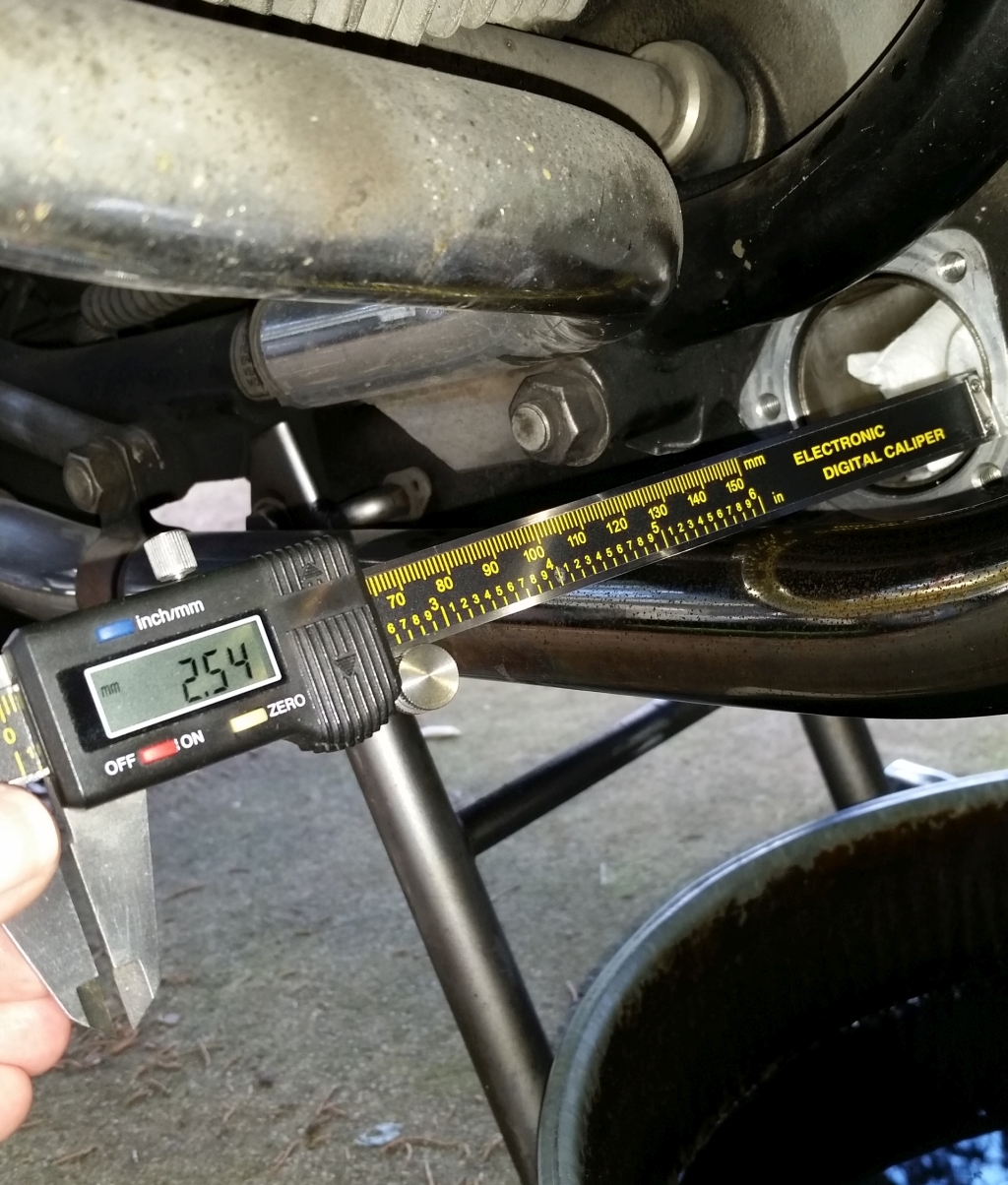

So maybe the new o-ring is black! I see a gasket there as well. Generally that's not used. Do you have a picture of the filter side in the engine, like the picture I posted above? It's important at this stage to measure the canister depth to decide if you really should be using that gasket. Here's how I measured my canister depth.

How does the black o-ring look? Does it appear to be still perfectly round or do you see some evidence of it being squished? I would expect that the o-ring would take on an almost square shape or profile.

It appears the shim is ass about, should go in before rubber o ring.
Being ass about won't cause an external leak, but might cause an engine killing internal leak if the o ring is cut by the end of the tube.
Hmmmm, I didn't think later bikes after '85 used a shim?
