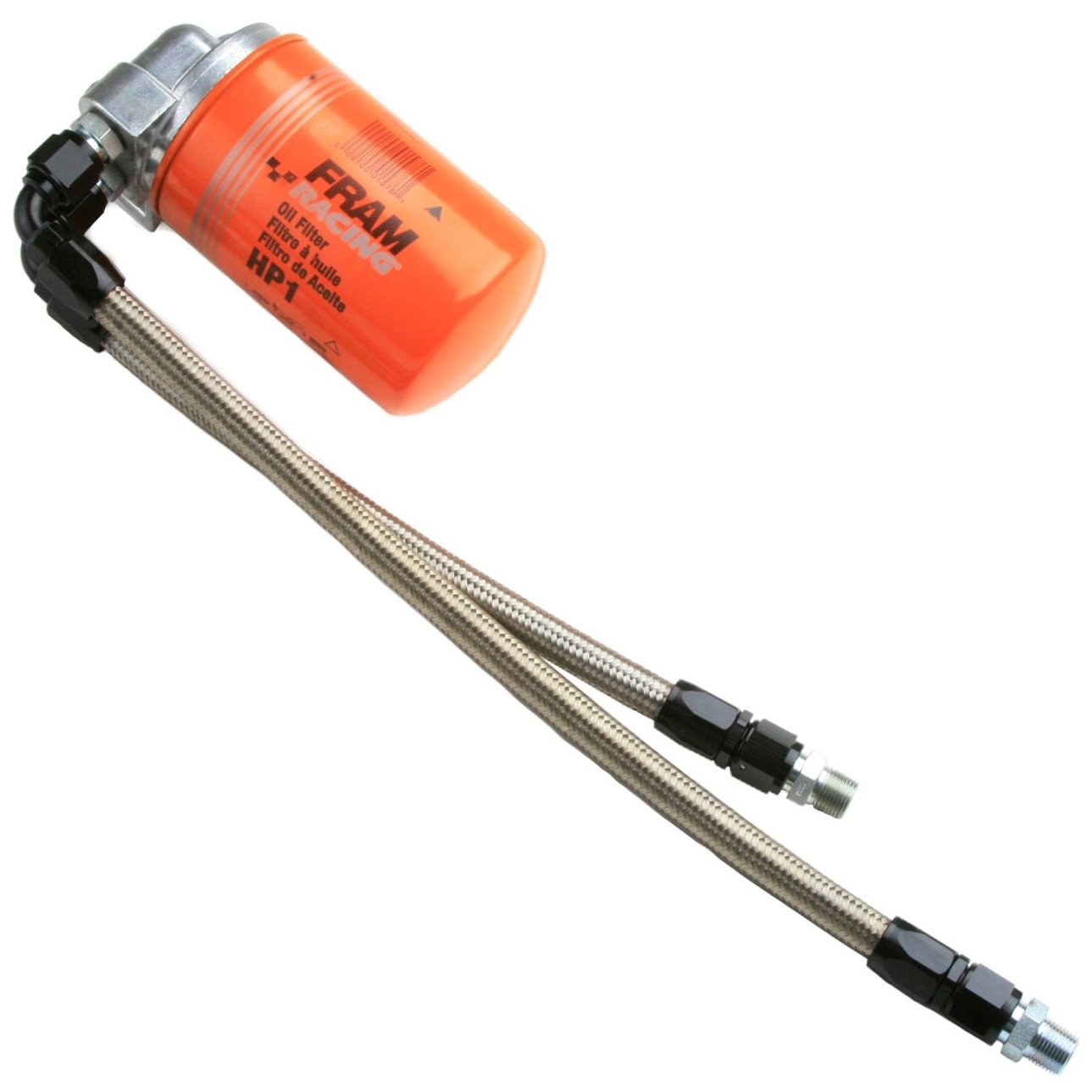

gspd wrote: Sun Aug 05, 2018 9:57 pm Something like this?
Very much like that Claude.
I'm thinking of my wood splitter, it has a remote oil filter for the hydraulic ram. I'll go have a look.
The oil lines to the filter would need to have the section of metal pipe like the stock cooler lines have, because it's going to be very close to the header pipe. Should be doable.
I might even be able to use the cooler lines with or without modification, but it shouldn't be too difficult to get something made.

Airbear wrote: Mon Aug 06, 2018 4:40 am Image
I'm just imagining how much longer a VW engine would last with one of those replacing the stock tea strainer.
We VW people do that quite regularly. Most recently on my last Kombi. One blocks the output from the pump and uses a pump cover that sends the oil out. Oil then rejoins the case at the main gallery.
The heads and exhaust valves remain the first item to go, but the bottom end bearings don't need replacement at the same time.
