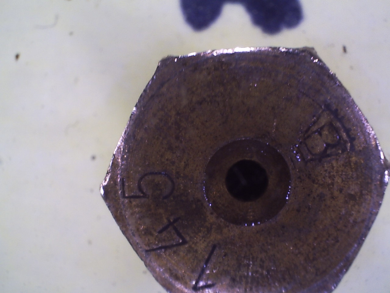

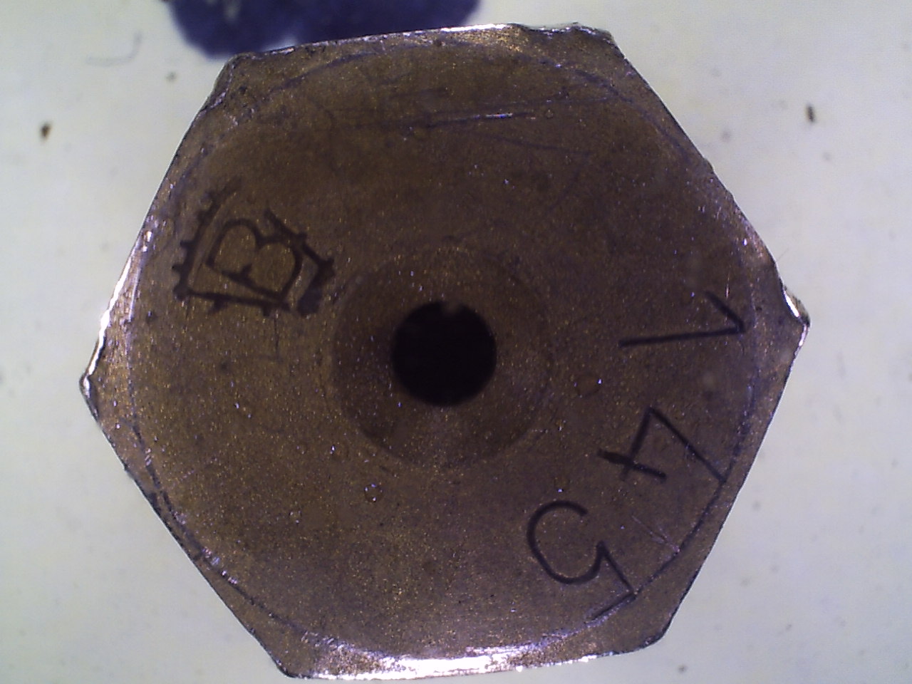

mkj wrote: Sat Jan 22, 2022 10:05 am Have taken some pic of my main jets, the top one runs but the bottom one doesn't cannot see why, will replace both with 145 but may also buy 150 just for something to play with. Any ideas

finaly managed it, the top pic is the main jet that works , the bottom jet does not work. I cannot see any real differance.

If the main jets are clear, then I doubt if that is the problem, after all they are simply holes of a given size. If you want to be certain try fitting them to opposite carbs and see if the problem moves with them.

You could try testing the jets for size to see if you can detect any difference between them. Short of proper pin gauges anything that's close to the correct size like a twist drill may help to highlight if they are both the same. I have a set of miniature drills that go down so small that they are hard to see with my old eyes. From the data I have, a 145 jet hole should be approx. 1.25 - 1.28 mm in dia.. Another technique might be a sewing needle that is just too big to pass through the jet. The length of tapered needle that passes into the hole would be an indication of any difference in size between the jets. You won't be able to measure the jets accurately with these methods but it should be easy to detect any significant differences.
