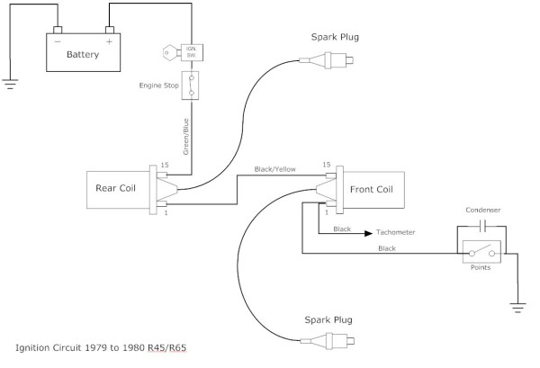

I can run a wire from the condenser to the positive terminal of the right coil
Huh? Left coil + gets 12v. The - terminal of the left coil is jumpered to + terminal of the right coil. The - terminal of the right coil goes to ground through the condenser.

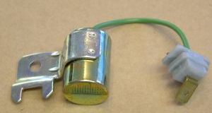

jjwithers wrote: Sun Nov 04, 2018 6:10 pm does the points signal run through that condenser wire?
Yes it does on the bean can points set up. The condenser termination block is a pass through used to locate the spade terminal that connects to the points.

jjwithers wrote: Sun Nov 04, 2018 6:10 pm I'm guessing that if I want to bypass the Dyna, I can run a wire from the condenser to the positive terminal of the right coil and that should take me back to 'stock'. The left coil has the green power wire to the positive.
Yes that will work but as already said it's the -ve terminal #1 and not #15

Yep, i bypassed the Dyna and it fired right up. No problems. I yanked it (dyna) out of the bike and Going to run my points without it until I feel like spending money on an electronic ignition for it. Thanks for the diagram. It was exactly what I needed.
